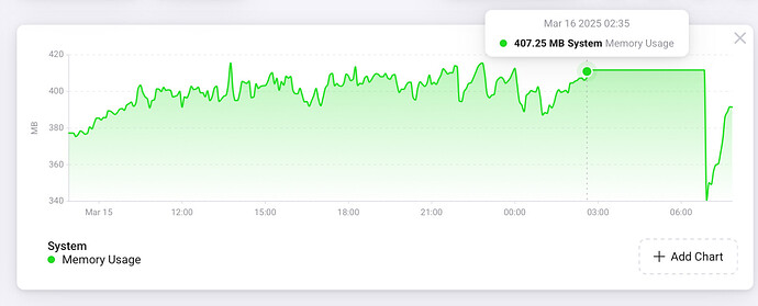

I think it’s a memory issue and happens after Homey is running a certain amount of time.
Support has raised the issue with the development team so far now a workaround is to make a flow to restart Homey just after midnight because the auto backup is usually around 1 am.

I ran into this issue this week as well. Automated backup crashes Homey each night.
So for now I created a workaround flow to shut down 5 or 6 apps that can be switched off for a while (and to start them offcourse :slight_smile: ) to free up memory.
Freeing op free memory to above 400 MB worked and allowed to make the back-up. I did not investigate it too extensively but during the backup in the overview Memory Usage an app “Other” appears, using around 350MB. I assume this is the backup.
