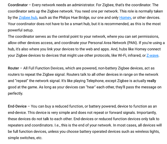

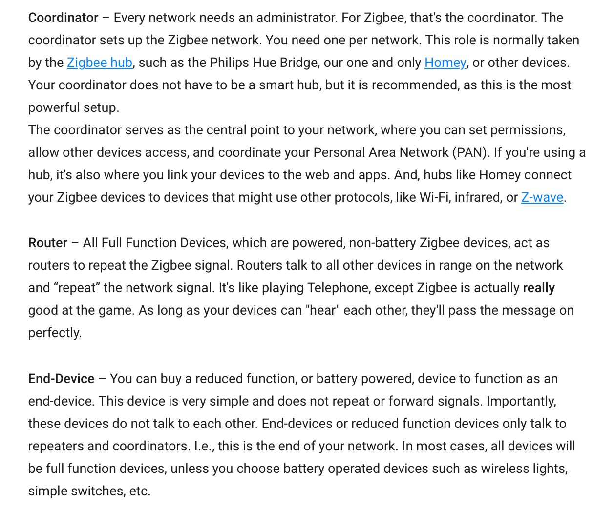

On the Homey Developer Tools webpage (that @Sharkys linked as well) you can see a “map” of your Zigbee network. How it is meshing/routing and what devices act as routers or end devices as well as what channel you´re on, with the option to switch channel.
Homey Developer Tools - Zigbee
Not on the HP2023.
Really? I did not know that.
It was removed because Athom apparently cannot implement it with the new Zigbee hardware.

I guess the “old little Zigbee router” is a Zigbee coordinator, right?
Every Zigbee coordinator creates its own Zigbee mesh. So the “old little Zigbee router” is not able to strengthen the Zigbee coverage. The problem is that they can even interfere with each other.
You also use Alexa. Does Alexa also use Zigbee? Do you have other Zigbee coordinators, e.g. a Philips Hue Bridge?
Zigbee also works in the 2.4 GHz frequency, i.e. in the same frequency as WiFi.
Depending on which channels the devices are set to, they may interfere with each other.
