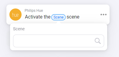

I recently bought a Philips Hue Bridge and a “Philips Hue Go” light. I have connected the Hue Bridge to the same network as my Homey Pro via ethernet cable (Homey is also on ethernet).
In my Philips Hue app on my phone, I have successfully added the new light and set up a so-called “scene”, in which my light turns red.
My idea was to trigger a Philips Hue Scene via the flow card below, but for some reason my Homey Pro can’t detect any scenes when I search for them.
It seems it is unaware of the Philips Hue Bridge’s existence. How can I connect my Homey Pro 2023 to my Philips Hue Bridge?
Thanks in advance for any help.
If that were the case, you wouldn’t have been able to pair it, and you wouldn’t even have the flow card you’re showing now.
You might need to add at least 1 light to Homey so the bridge connection is made.

You’re right, the Scene card is an app card. I think @Caseda is correct in that you need to pair at least one (supported) device that’s handled by the hub before you can set scenes.
