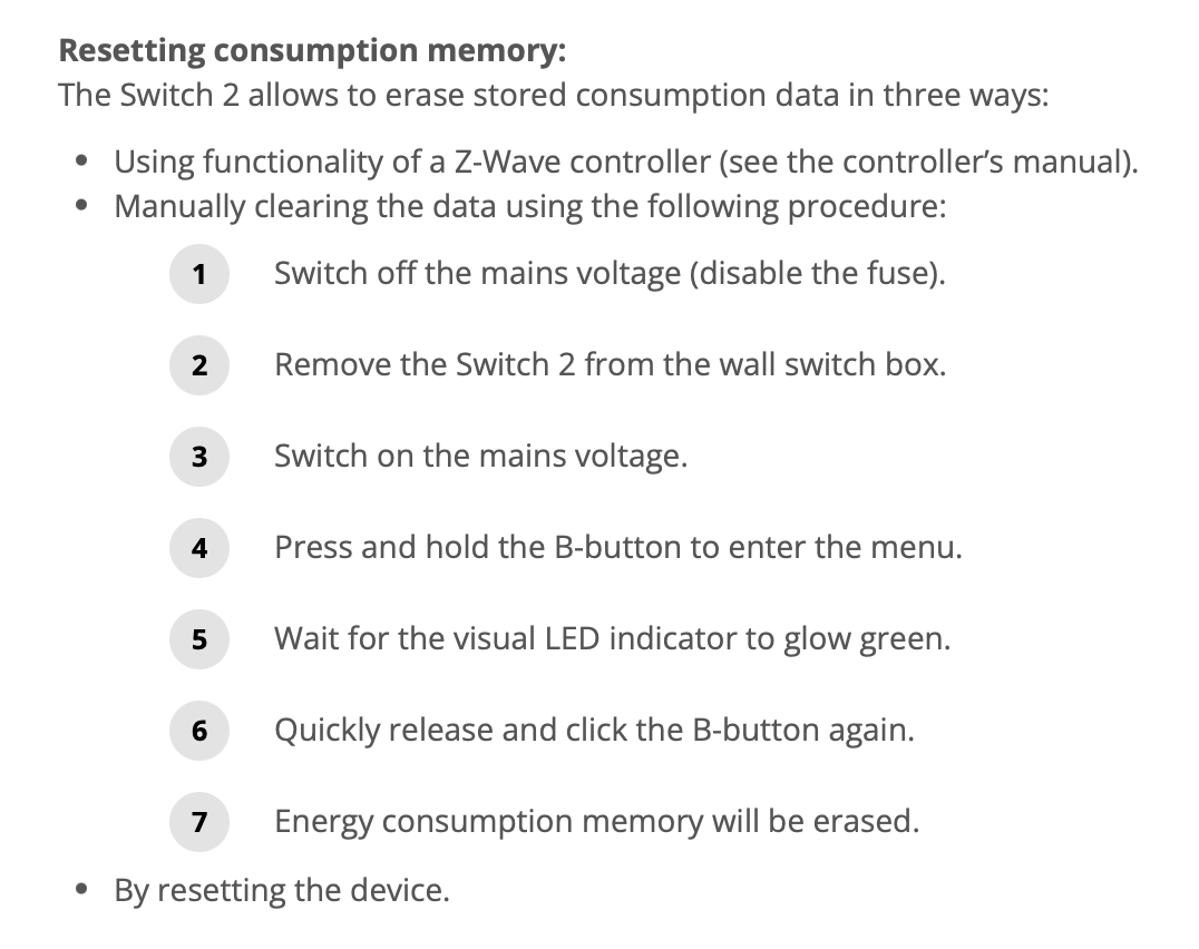

That does not clear your data in your wallplug/switch !
The consumption of the Aeotec HDSS can be cleared via flow card:
The consumption of the Fibaro SS2 can be cleared in three ways:
