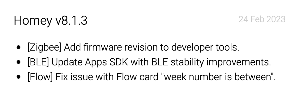

Homey Pro v8.1.3-rc.2 Experimental
  • [Zigbee] Add firmware revision to developer tools.
  • [BLE] Update Apps SDK with BLE stability improvements.
na update Homey Pro v8.1.3-rc.2 Experimental
