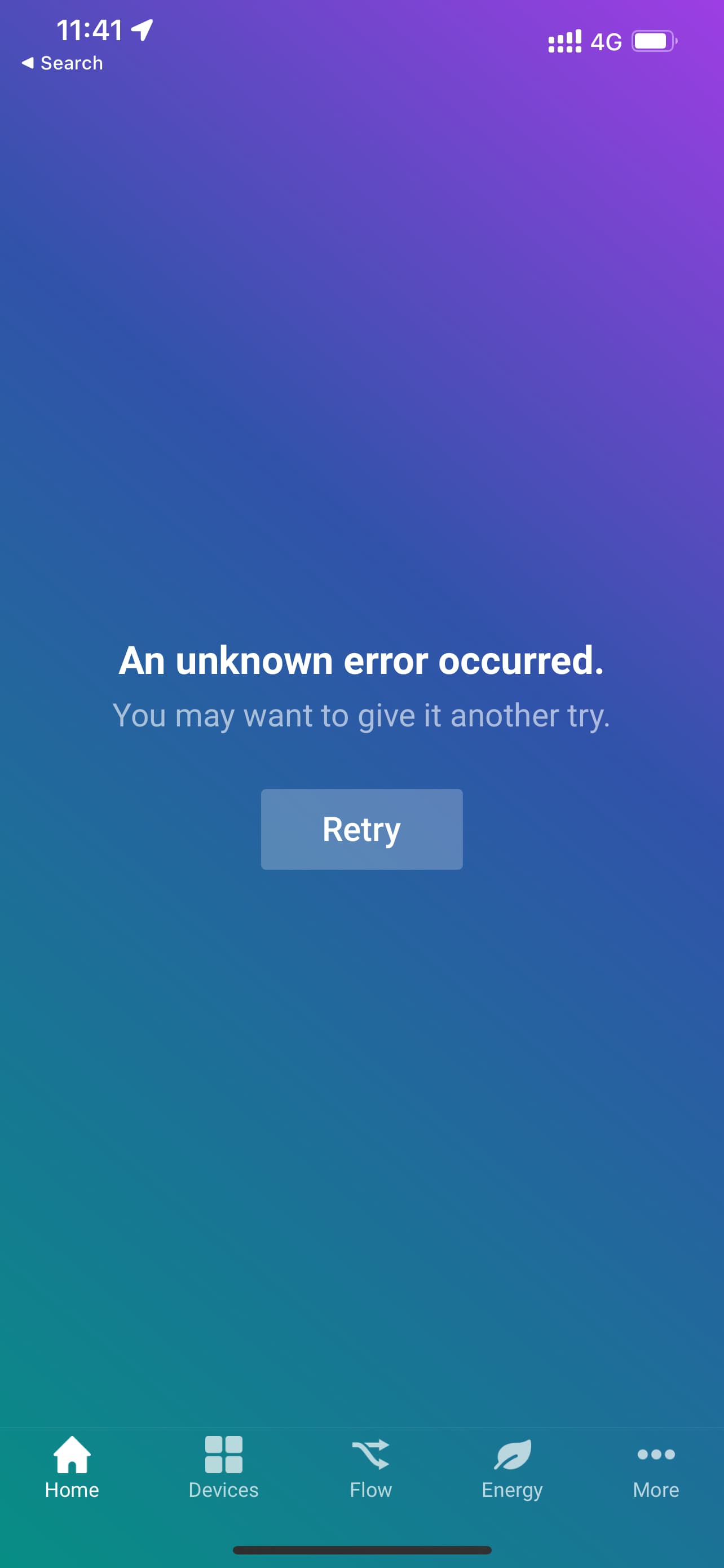

I have purchased homey pro to replace my old smart hub “vera”, i like almost every thing about my homey, but not the offline message, I am getting this every time i open the app, some times i have to wait one minute or more to get it connected, I never faced this issue before with vera… even i didnt face any issue with my wireless network at my home because its fully well well covered.
I got this quite often, lets say if i open the app 15 times a day, i get the offline 11 times.
Examples of getting offline message:
  1. trying to open the app > offline message.
  2. while the app is connected i get disconnection message > reconnect with 5 seconds.
  3. even when i try to add some devices, in the process it disconnects and i have to repeat adding the device again.
My main router is tplink, my homey version is 7.2.0.
While writing this topic, i kept my homey app on iphone open, it got more than 10 times disconnected and reconnected, really annoying, i even have screen recording of what happened!

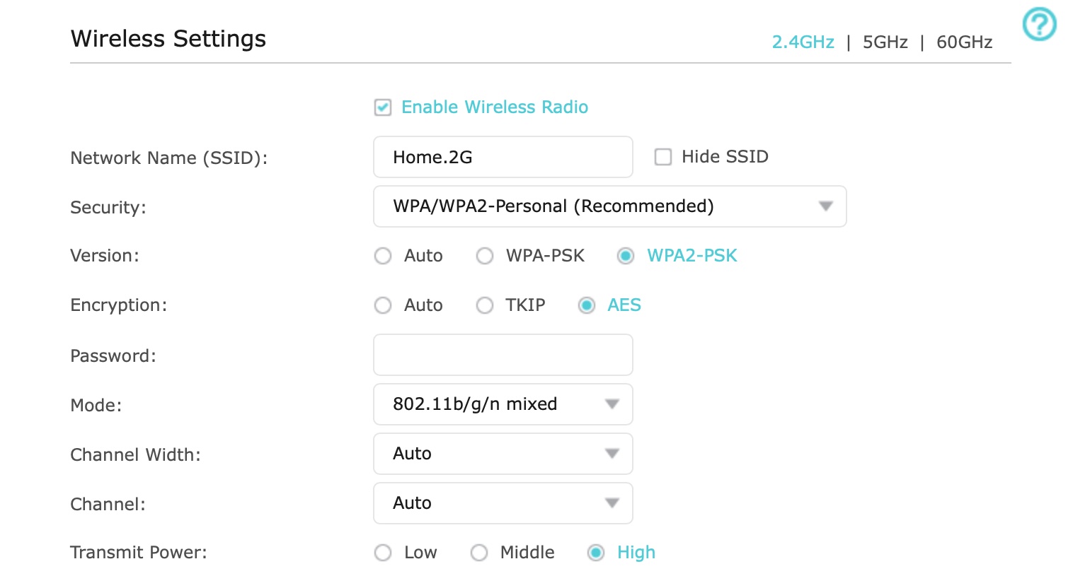

Turn off the 20/40 mhz coexistence. I had trouble until I turned that off
I cant turn it off, either 20 - 40 or auto, i tried using each option for 5 mins each, ended up with same issue. Here are the options i have on 2.4g wireless network.
20/40 coexistence is something different, probably burried somewhere in advanced options if you can disable it.
