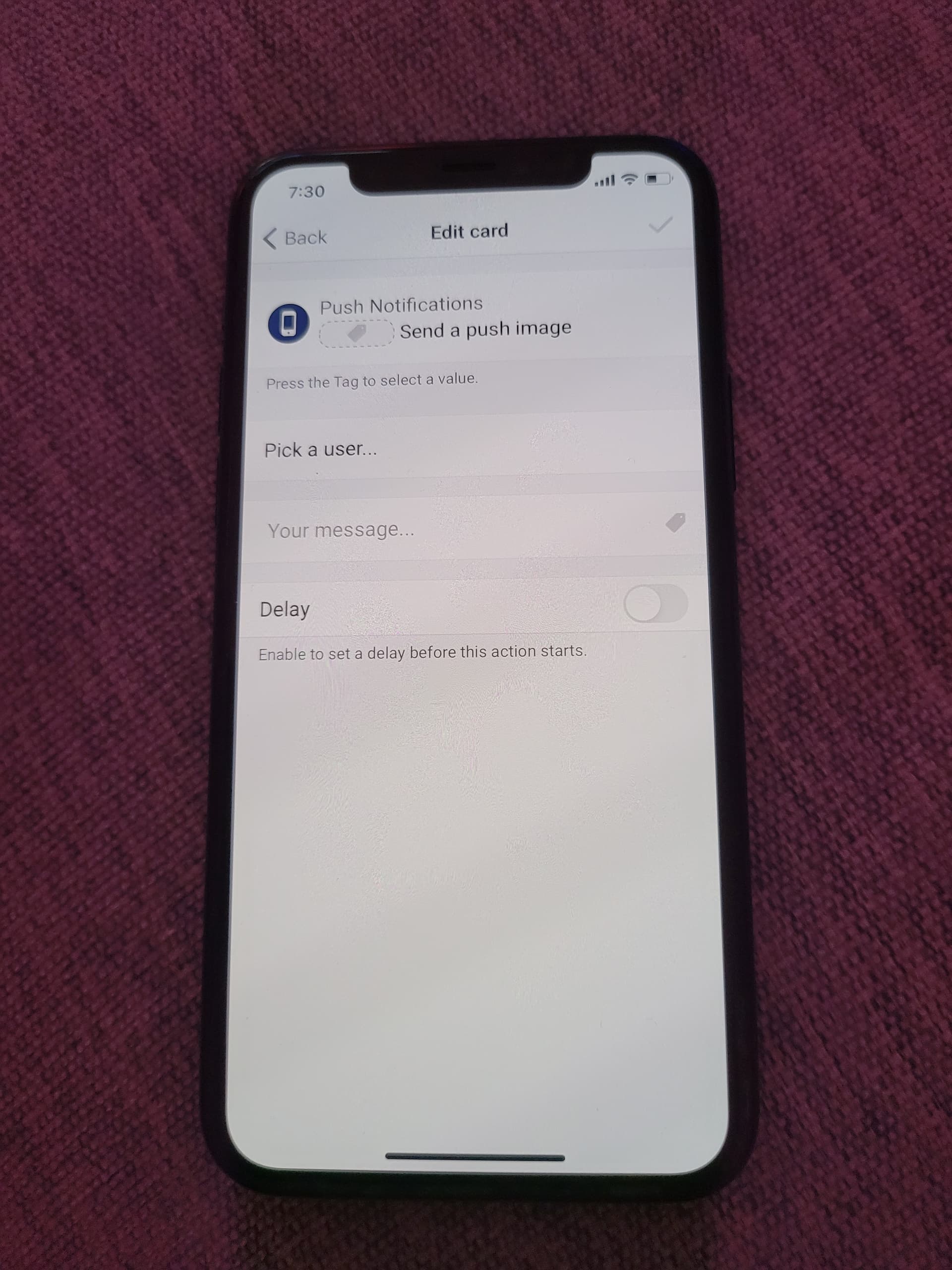

Only in the header of the push flow.

It has a tag, but I can only select it in the (push notifications), send a push image under the top banner and not the tag section down at message.
Would I possibly need to create a logic and update the logic with a flow and then push that image from logic to the neeo?
Push messages are only used to send a message to a mobile app.

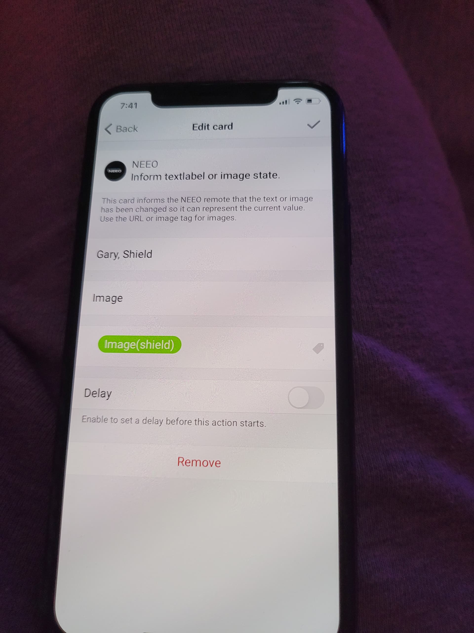

The screenshot 2 shows a flow action card for your Neeo? If yes, then you should try to send the image from your Sonos to Neeo using this action card in the then part of your flow. Select the Sonos tag using this small button
That’s the problem. Under that tag button you identified in your photo, no purple image tags show up.
I can only see any purple image tag options under the push notifications. :sob:

So it seems the flow parameter is defined as text field (perhaps for a image url). A second parameter for the image is missing.
You can only ask the developer of Neeo app if its possible to extend this flow with a new image parameter.
