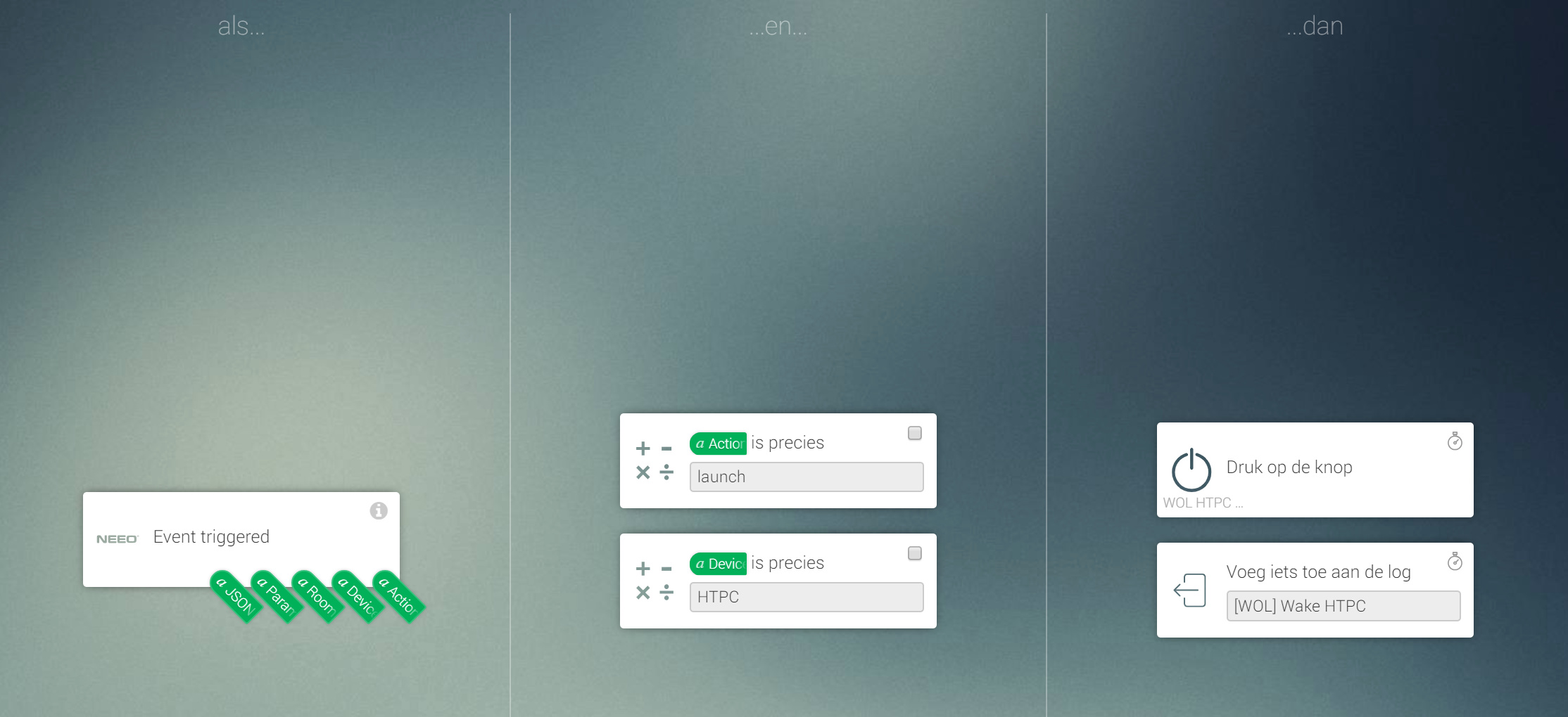

Hi, First a small donation from me for your great work. Seconds, is it possible to add a trigger when a recipe started, i tested with event triggered but homey reacts of all neeo actions. I want only a trigger when a recipe started, Changes and recipe turned off. Is this possible?
Thanks again
Thanks m8, I really appreciate that.
You can act on events like this, This can be any recipe or button, etcetra.
Annotation%20(2)
Does this help?

@Niels,
I made a simple flow but dont works, can you please look into this.
