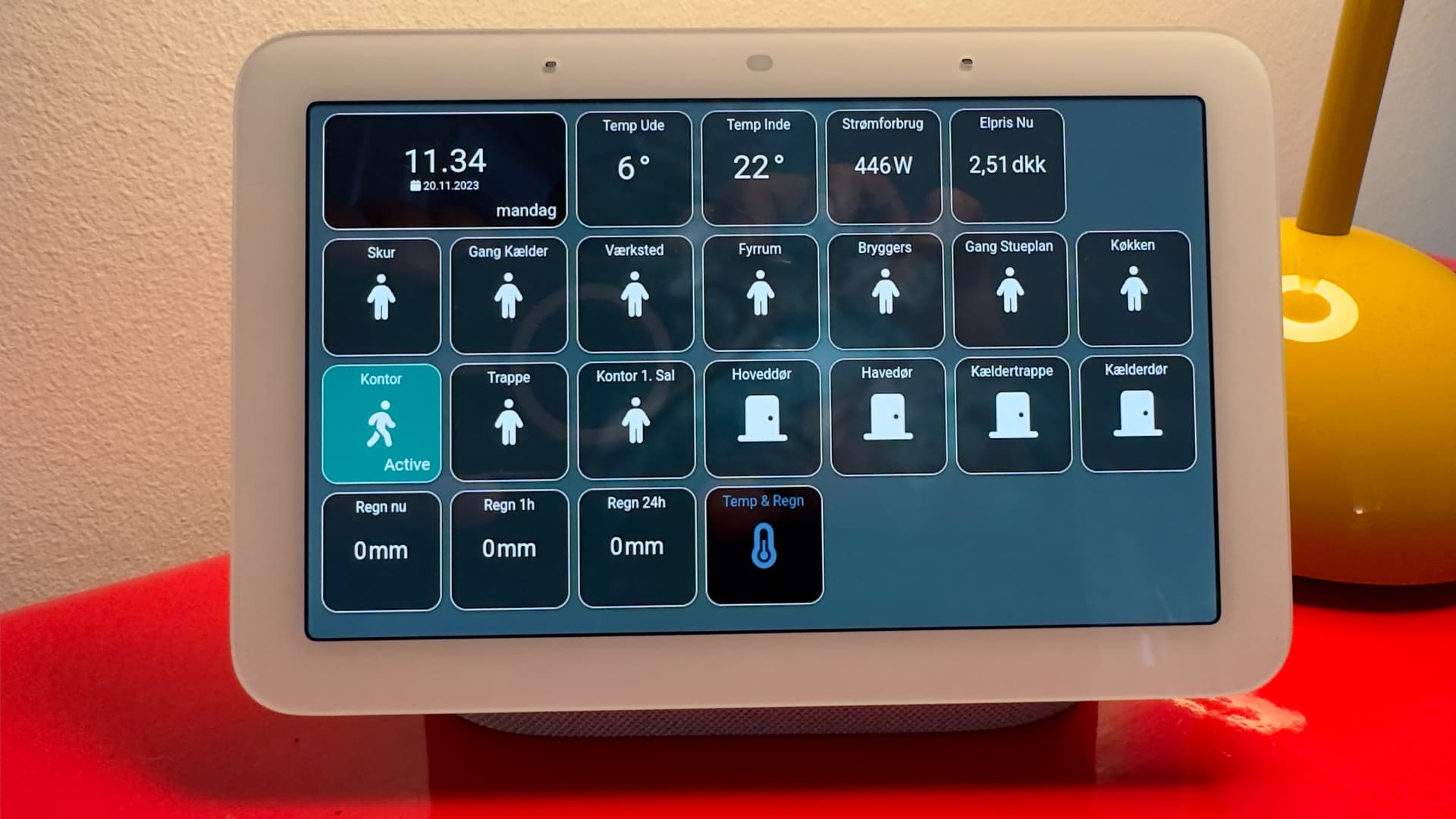

Hi all,
I got myself a Google Nest Hub 2nd Gen, with the idea to use it for Homey.
I’ve used Smartthings + Sharptools for years, and have come to create some cool dashboards for my phone to control lights, thermostats etc, and to get info from my motion sensors (Hue) and door sensors (Aqara), and it worked great.
I moved to Homey Pro and ported the devices there with only little issues; then created new dashboards in Sharptools, and was happy.
But I wanted the Dashboard on my desk, always visible, and I knew with some tricks I could make it work on the Google Nest Hub 2nd gen.
I was inspired by the HomeyDash concept, and used the ideas to use with Homey + Sharptools, and this is how it looks.
Here’s the flow:
Happy to answer any questions if you want the same.

Not an app; you simply “cast” the webpage to the Nest
But the cast will not last longer then about 9 minutes so you have to create a restart flow.
Correct, if you look at my flow in the beginning of the post, you’ll se that this is what I’m doing
@Carit_Stenberg but your flow start with something called kontrolpanel, that’s your tricker, But what is this app? I think that is what @aunmo is asking because I have same question. :slight_smile:
It does not matter what the device “kontrollpanel” is or which app it uses. This is just the trigger he uses for starting the flow.
You can use whatever trigger you want to start your flow.
Correct, “Kontrolpanel” is just a trigger to start the flow.
