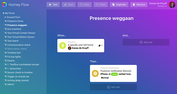

Homey Flow for Web - three Column view [CSS customization]
Of course everyone is happy With the new Flow for Web App!
but some where more happy using a flow editor in three columns.
The nice thing is with a extra CSS file you can customize the way your browser presents it.
Lucky for me (and you) some Homeys on Slack already shared what they like.
As I am no CSS guru I asked how they did. Thanks to Rob and Bjorn I got some Code.
The people using Linux with fe Epiphany probably know how to use it.
As I use Chrome most of the time I installed the extension StyleBot and added a small css code.
Opened Flow Web App:
Only thing to configure after a default install is the following code for the url: flow.homey.app

If you use FireFox you could use it with Custom Style Script.
For what I have tested everything works as normal, but pls remove it before reporting issues with the Flow for Web app to Athom as it will be a problem for them supporting everything with the PBKAC error’s :wink: !!
Have fun!

If your screen width isn’t enough and this happens with the custom css above:
just add
.Sidebar {
    width: 7%;
    overflow: auto;
.Sidebar:hover {
	width: 301px;
This will slide in the Flow selection column and widen it when you hover over it to select a flow.
