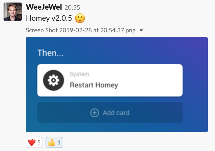

Homey v2.0.5-rc.2 has been release to the experimental channel, amongst other improvements it adds a new experimental functionality: Power user.
This new function enables advanced Flow cards & system profiling in Insights.
These are the Flow cards (in the System category) that become available when you enable the Power users Experiment:
The Restart Homey card makes the instruction below superfluous but I will leave it here for informational purposes.

Homey v2.0.5-rc.2 has been release to the experimental channel, amongst other improvements it adds the new Flow cards, check the opening post for more information.
I would really appreciate if Athom could introduce the option to select an app and restart it within Flows.
I would also appreciated the Reboot Homey option within Flows too.
Any reason this hasnt already been introduced? It seems a simple and obvious solution to me for a number of reasons.
These functions where introduced more than a month ago in 2.0.5.
You need to enable the power user experiment.
See here:
So closed and moved there…
Again Dijker, thanks. This is very helpful. Another menu I didn’t look into, experimental. :grin: Love it.
