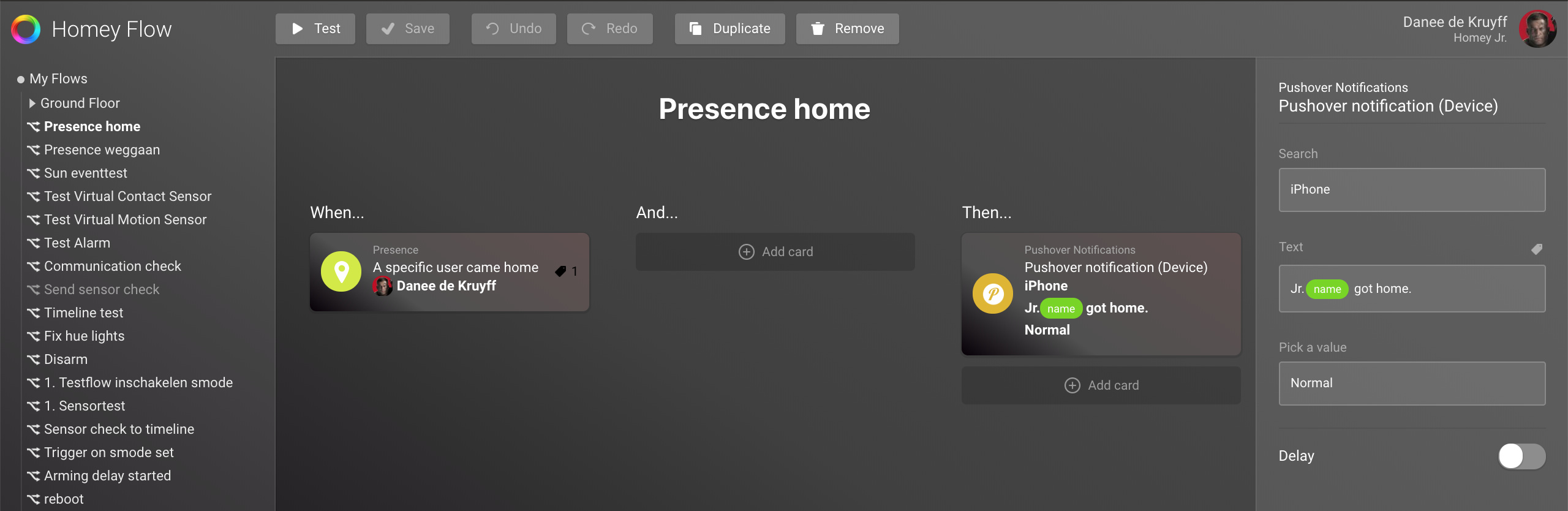

Enhanced the dark mode a bit
body {
    background: -webkit-linear-gradient(55deg,#050005,#404040 50%,#505050);
.FlowCard {
    background: -webkit-linear-gradient(55deg,#060006,#505050 30%,#605050);
.FlowCard>.Content>.Delay,
.FlowCard>.Content>.Duration,
.FlowCard>.Content>.Title>.Text {
 	color: white;
.FlowCardArgument {
    color: white;
.AddCard.Visible>.Inner {
    background: -webkit-linear-gradient(55deg,#070007,#606060 70%,#605050);
input.SearchInput {
    background: -webkit-linear-gradient(55deg,#403030,#606060 80%,#040004);
.AddCard>.Inner>.Search>.SearchInput {
    color: white;

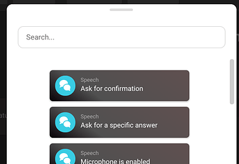

Little addition for the dark theme so the dialog to add a card is also dark
input.SearchInput {
    color: white;
Before
After
Great! I will switch to the dark mode. Beautiful!

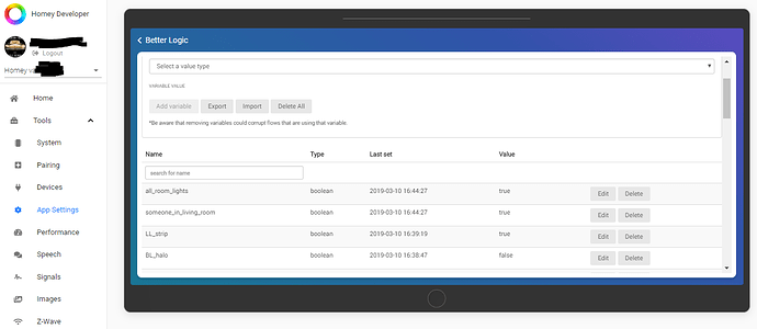

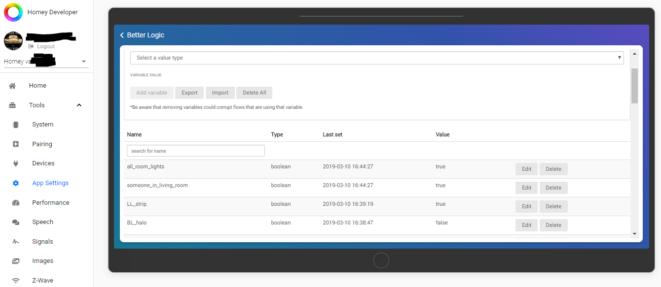

For the people who hate the telephone simulator in the app settings of the Homey developer page.
Here the chrome css, tested with stylebot extension for the transformation into a tablet :grinning:
https://developer.athom.com/tools/app-settings
/* Make all elements invisible to hide the simulator selector */
.Page.PageToolsSettings {
    visibility: hidden;
/* But still show the phone itself and flexible resize and realign */
.Page.PageToolsSettings .Simulator {
    visibility: visible;
    width: 150%;
    margin-left: -50%;
/* Finetune the layout of the screen */
.Page.PageToolsSettings .Simulator .SimulatorInner {
    width: 98%;
    margin-left: 1%;
    margin-right: 1%;
/* Now the phone is a tablet :) */
