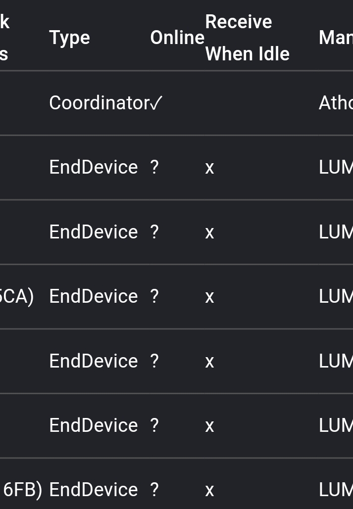

Hi! My homey cant find none of my devices anymore. Its been connected to the devices earlier and worked just fine. I can see the different icons to the devices Ive made, but none of them are working. I have restarted Homey to fabrics and startet over, but with no luck.
Ive tried homey developer tools, but all of my devices are showing their not connected.
Nothing is changing when i try to interview the different devices, nor change the value from false to true… It does not work either on the web app or phone app. It happend after the last update, and I dont know what to do.

Yes @Philip_Montgomery .Tried it multiple times. Ive noticed that homey does respond to the heating cable. Its only all the light flows and devices that homey dont want to respond to
Termostat for floor heating
But this is normal
(from your screenshot):
Afaik, “online” is always ?, except for the ‘coördinator’;
And “receive when idle” is always X for end-devices and V for router-devices.

What data is returned when you interview a router device?
You can’t interview an end-device, unless you keep it awake by pressing the pair button briefly every other 1 or 2 secs.
