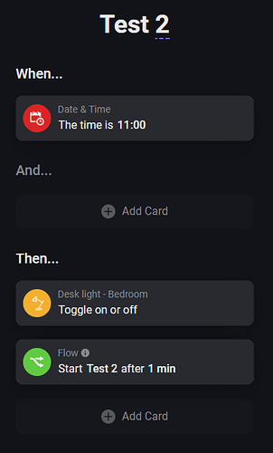

I tested a workaround, where a flow started at a certain time and then is repeated every X minutes. It seemed to work and only one flow is needed. Then if you need to stop it for some reason, you can enable or disable the flow.

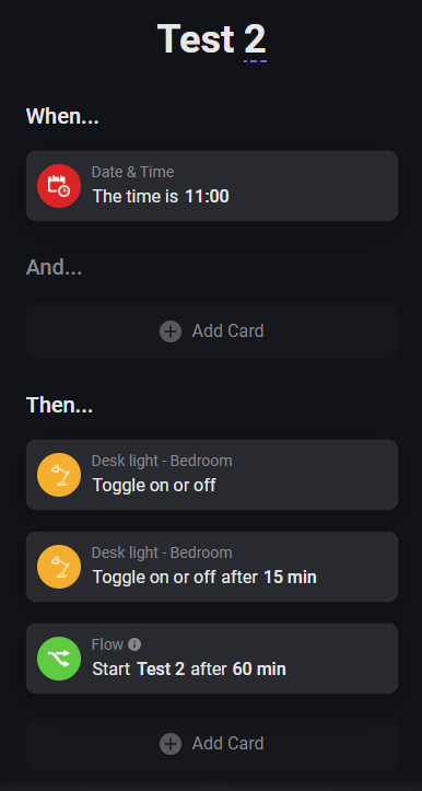

Here’s with the pump frequency.
Nice clean solution that fits my purpose Kala :slight_smile:
