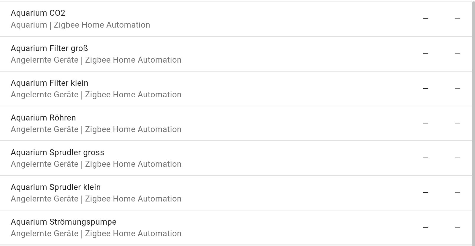

Take a Raspi and install Home Assistant on it. Connect the Raspi to your network via LAN or WLAN. Connect a Zigbee and/or Zwave stick. Register your devices with HA. Now import these devices into Homey via the Homey Home Assistant app.
You now have a perfect access point for Homey and can control the devices registered with HA via Homey Flows.

Osram Plugs on Home Assistant
The plugs imported in Homey
