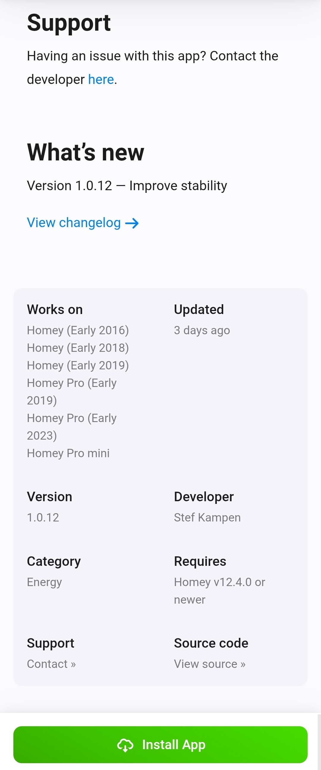

Another suggestion, It’s very difficult to find a way to contact the developer, which is extremely frustrating. For the Zendure app, the provided link leads to a generic support page with no reference to Homey. Any official app should include a clear and direct way to reach the developer.
(I’m ’still using NOUS powerplug to get the Solar Power, but doesn’t work well)
Well, it’s extremely clearly mentioned multiple times at the app store pages. But few seem to actually read it.
‘Official’
‘Community’
Search engine still works as well, first hit sends you to the app page:
https://duckduckgo.com/?q=how+to+contact+the+developer+of+Homey+zendure+app
Yes, I know, I followed the link, but it leads to the Zendure support site, where it’s not clear how to submit a support request specifically for the Homey app.
For the local app I believe you can find the people behind it on the Tweakersnet forum: https://gathering.tweakers.net/forum/list_messages/2306860
