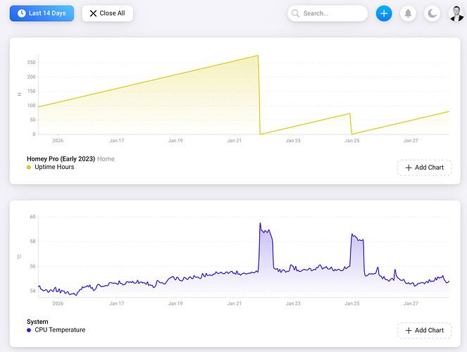

I have a somewhat similar experience. Having never previously seen an unexpected reboot in many years of using Homey, I had 2 in the past 10 days. So not quite as unstable as yours (yet!). I was scratching my head about it because I too have no apps with unusual memory or CPU usage, nothing obviously changed in the set up in that period and no under voltage or any other issues in dev. tools or sys internals.
The only thing I found which correlated with the reboots was CPU temperature, which rises by a few degrees after each reboot for a period then drops again. But my leading theory for this is it’s the red ring. My Homey (Pro 2023, modded with a new CM4 a few weeks before this and otherwise showing normal CPU temp since) lives in an equipment cupboard with the LED ring switched off, so if it’s showing the red ring after unexpected reboots for a period then switching off, that would likely explain the temp chart. Both reboots happened overnight so I’ve not been able to catch it in the act yet to check.

Thanks for your inputs. My theory is that CPU Temp. spikes are related to the system booting up, so it’s running for some time on 100% loading all apps etc.

Yes I also thought the temp spikes might be initial load after reboot but the temp spikes last much longer than that and end quite abruptly quite a while after the reboot was completed. See additional CPU 1 min load chart below. No obvious correlation there to my eye. So I still think the LED ring seems most likely explanation for that.

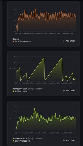

@Jonathan_Draper
Very different here
