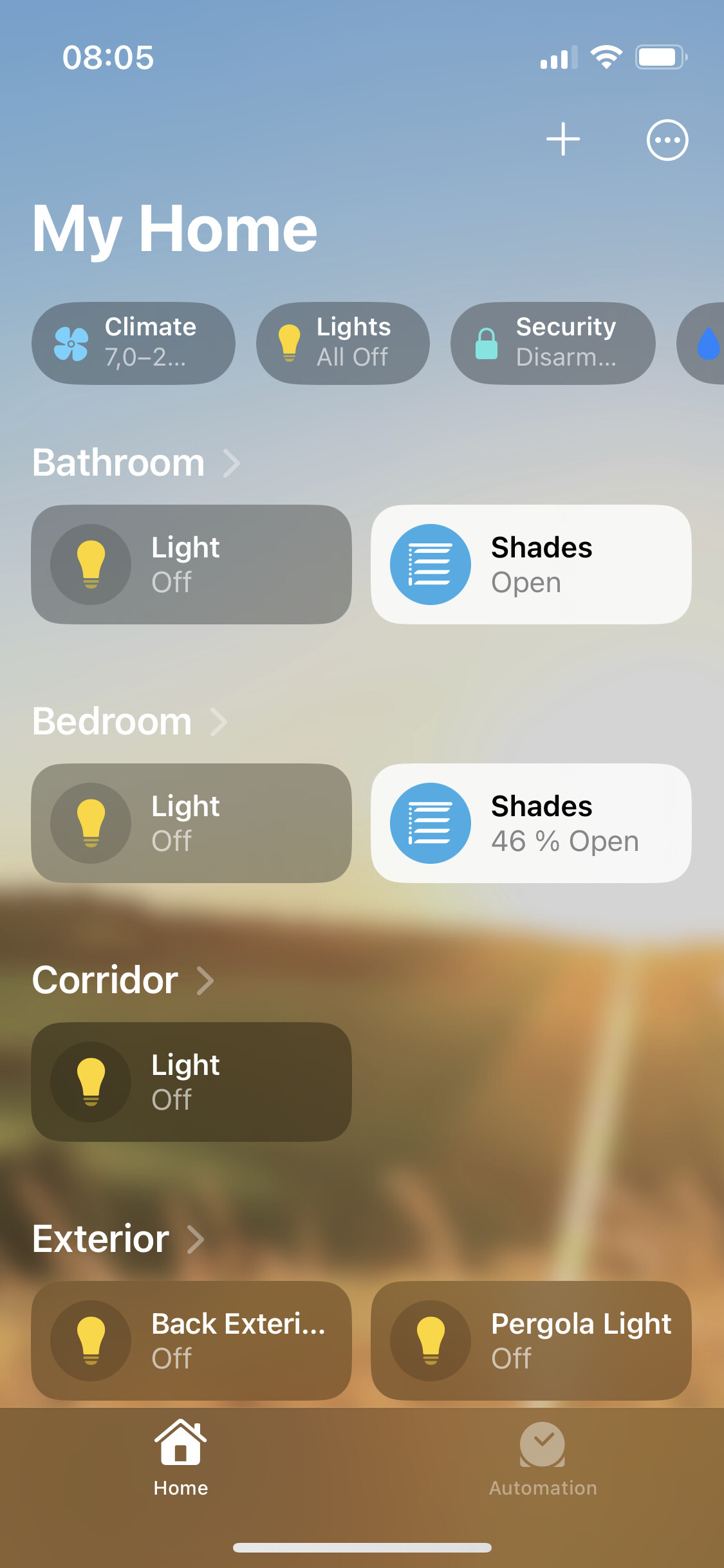

Hello guys I have a new phone IPhone 13 mini and I want to add homey devices into Homekit.
I add devices and Homey is in there, but I can’t see temperature sensors. For example lights are working good.
What is weird, my wife has iPhone also (iPhone SE 2020) and she see also temperature sensors. What am I doing wrong please? Also u can see that my shades are like switch and my wifes they have more functionality.
Here are screenshots of my and her Homekit:

Great now it works! Thanks.

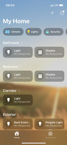

But now I have another issue. When I am on the WiFi it works well but when I am on mobile data all of my devices are in “no response”.
Do you have a Home hub (like an Apple TV or a Homepod) correctly set up? If not, HomeKit is purely local.
oh…thats new for me, thanks. That Homepod is similar to Google nest, right? Now when is my family in Apple, maybe I should switch.
I don’t know how exactly the Homepod compares to Google Nest, but I think they are quite similar, yes. You need an “always on” device for HomeKit to be able to use it outside of your local network.
