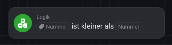

This is the wrong logic card… :man_shrugging:t3:
You use this one:
But you need this one like @Peter_Kawa showed already in his screenshots:
Yes, I tried that. It’s in the post above this :slight_smile:
