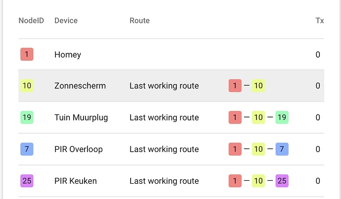

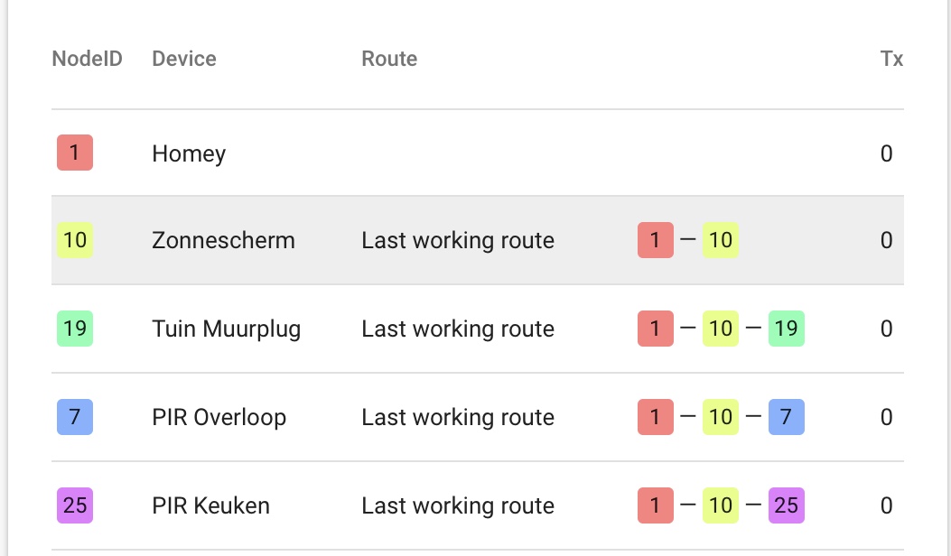

I already removed the PIR Kitchen, which initially works but somehow (i guess) a new routing is created which screws up the performance of my PIR Kitchen which keeps seeing motion the whole time. I noticed a difference in the routing sequence. 1-25 (Homey and PIR Kitchen) works great. After a while the routing changes into 1-10-25 (Homey, Fibaro Roller Shutter in the kitchen and PIR Kitchen) and my PIR Kitchen doesn’t stop seeing motion.
With a heal on 25 the routing changes back to 1-25 but after a while changes again to 1-10-25
- How can i change the sequence? 10 (Fibaro) was initially the last item i have bought and added to the network long before the birthday. Do i need to reset my Z-wave network and add every item in the same sequence as in the beginning? Unfortunately i do not know how the initial Z-Wave routing looked like since i ran into the developer overview during this issue
- How bad is the difference in numbers (1,7,10, 19 and 25)?
