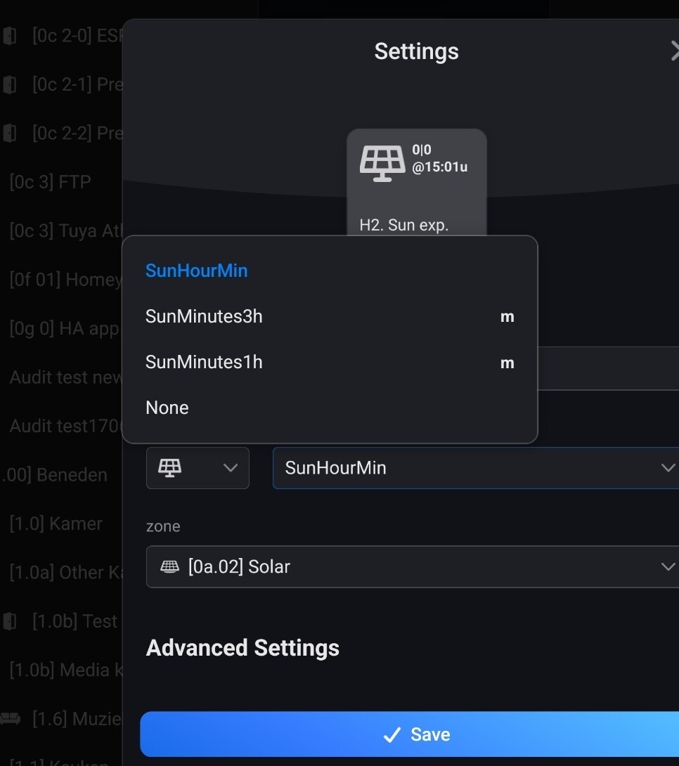

In the web app you can switch to the larger icons and that will display more the capabilities.
You can create an AVD and, for example, “mirror” the humidity value from your sensor. Then you will have two separate devices, but you can see both values at a glance:

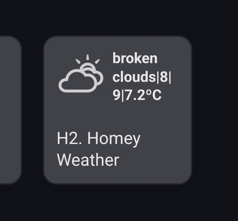

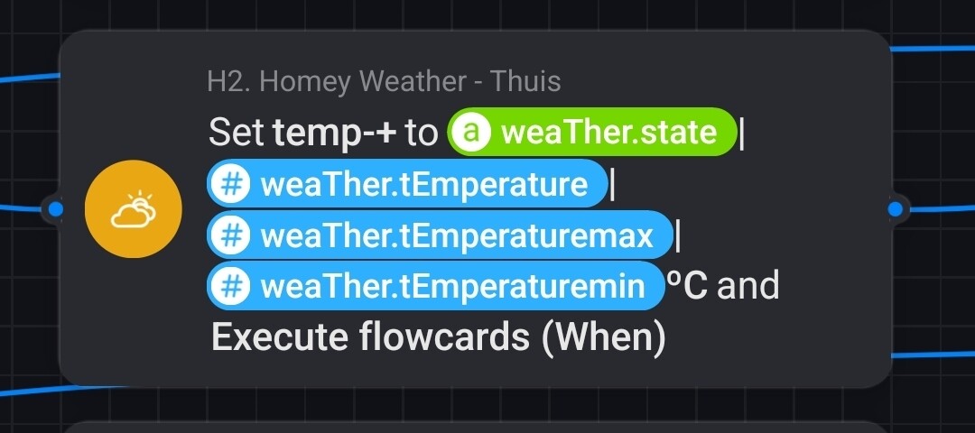

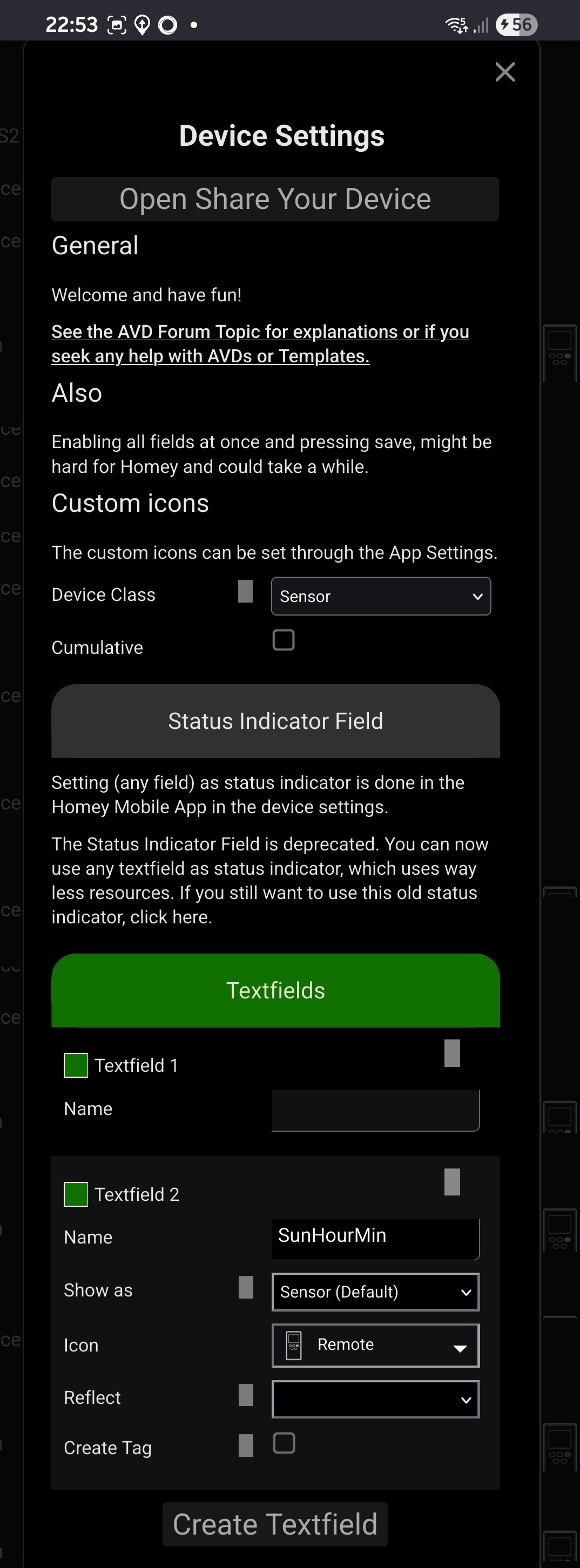

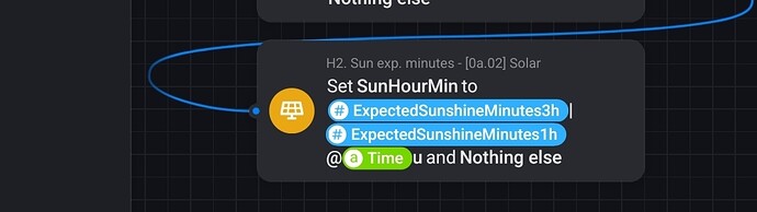

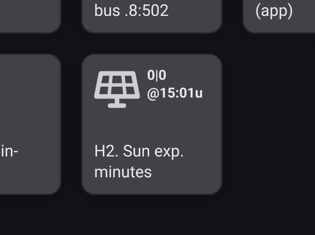

With an AVD you can combine two fields in one field. You have to experiment with adding extra spaces to have the line break at the right point.
thanks but that’s just the result I’m expecting without knowing how to get there :innocent:
Another example, this one is for the weather:
