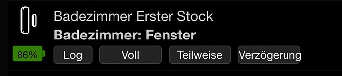

Hello DaneedeKruyff and everyone who is helping me.
I think I understand the app and it works great. I would like to use the sensor query for a slightly different purpose, as I want to know which alarm-relevant windows in the house are open so that I can react to them in a different flow, regardless of the status change of the alarm.
Unfortunately, when I check the Sensor Active card, which I check via the Check Status of All Sensors card, it triggers all sensors that are configured in Heimdall, see image of the bathroom sensor: window. This is not configured, but the status is still displayed. In the Device card, only the preselection list of the Heimdall sensor list appears, but not the variable view from the previous card. Is this generally not possible?
Apologies if I am posting in the wrong forum; unfortunately, as a new user, it is not so intuitive to navigate.If I am doing something wrong, please briefly explain what the correct approach would be
Can’t you just create a flow that does not relate to Heimdall?
Sounds like a “if this sensor does this, then that” issue. The only drawback being that you need to make it for eacht sensor.
Aaaahhh, you want to use that particular card. It unfortunately doesn’t have a tag picker available.
That wasn’t clear to me.
But you can use the tag in a timeline notification card for instance.
That’s exactly my problem. Thanks, Peter. I couldn’t put it so succinctly.
Can you describe what you mean in more detail? How can I see in the timeline that this sensor is not part of the alarm configuration?
I found the idea charming, as Heimdall has everything it takes / works perfectly and makes this process very dynamic.
YW.
Like in the screenshot in a previous post. I added a timeline notification card.
