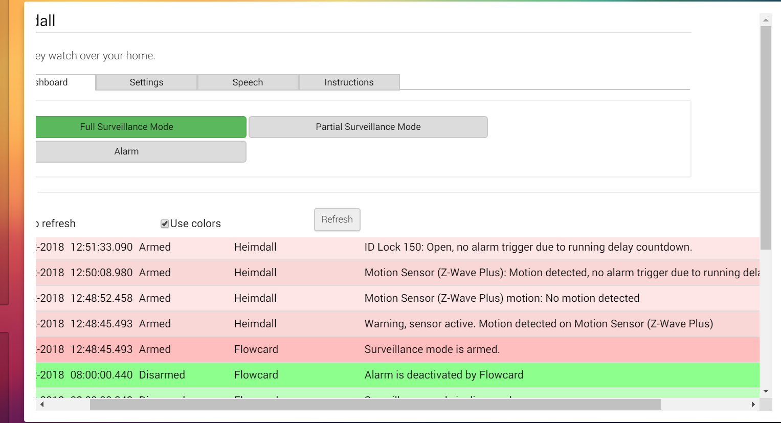

I have done all this but i cant get the system to trigger the alarm and send push message.
When i do a test of the flow everything works fine.
When checking Heimdall`s log i get “motion detected, no alarm trigger due to running delay countdown”. I have tryed with no delay and with 15 seconds. No difference. Any suggestions?

@molensky rc9 introduced a bug, it’s confirmed to be fixed in rc10:
https://github.com/athombv/homey-apps-sdk-issues/issues/19
For new versions, just keep an eye out on the alpha-V2 branche on github. I’ve been publishing small updates while not upping the version number, please check the duration since the last commit.
I can see no connection between the things you experience and what Heimdall does, it only listens to certain capabilities of devices and the only actions it takes are through it’s flowcards.
It somehow seems that Heimdall thinks a delayed countdown to an alarm is active. could you enable a Delayed Trigger on a device, select the Surveillance Mode on which that device should trigger, trip the sensor and let the timer run out (maybe enable some speech options so you can hear what’s happening). It should trigger the alarm and should reset the delayed countdown variable. After that set the Surveillance Mode to Disarmed and disable the Delayed Trigger on the device and see if all is functioning as desired.
Please let me know if the above helps.
