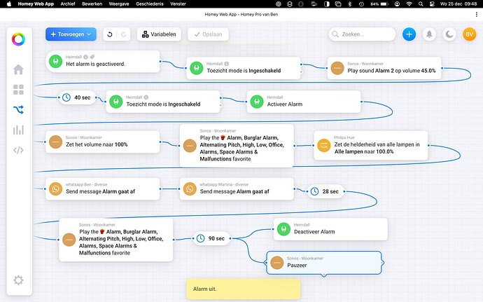

Who can explain to me what I’m doing wrong? I’ve created a flow to activate the alarm, and it works fine. However, I can’t turn off the alarm once it’s been triggered. I downloaded the alarm button, but it doesn’t do anything. Changing the mode to “disabled” also doesn’t stop the alarm notification.

Can you show a screenshot of the flow you created for the action when the alarm is triggered, like explained here: Heimdall - Let Homey watch over your home
Can you show a screenshot of the flow you created for the action to take when you want to cancel your alarm actions, like explained here: Heimdall - Let Homey watch over your home
I see you start playing sounds on your Sonos when the alarm becomes active, but I see no flow to stop playing on Sonos.
You will have to create a flow with the tigger The alarm is deactivated. That card gets triggered when you deactivate the Alarm State.
I see some redundant flows, for example; your Inschakelen toezichtmode are not needed and will cause continuous loops and thus unnecessary system load.
Also, the first flow under Alarm uit is redundant, and is basically does nothing without the before mentioned flow you need to create.

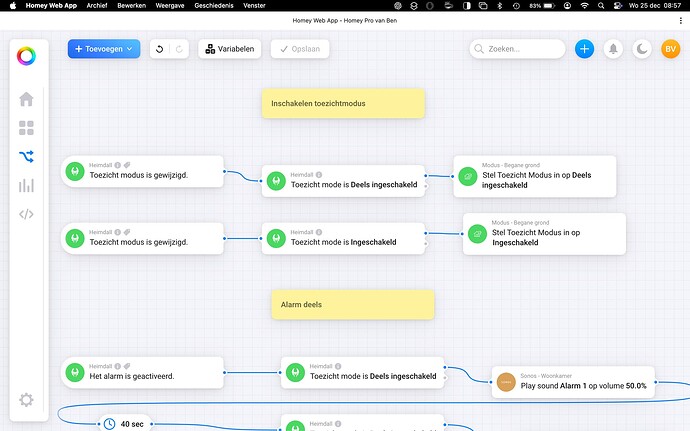

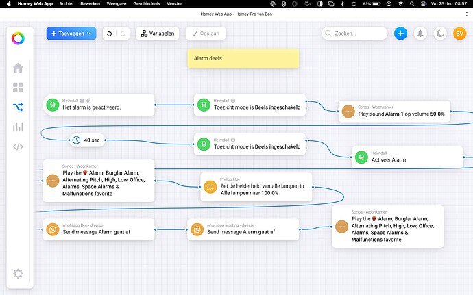

Thank you for your response. I’ve made some adjustments. Did I do it correctly this time? Thanks in advance!
Yes, partly. You will still need to create a flow with actions to take when the Alarm State is disabled.
You have a flow with the button that will set the Alarm State in Heimdall to disabled, but that in itself will (can) never cancel or stop the actions you’ve started in the flow with the trigger card The alarm is activated (Het alarm is geactiveerd) so you will have to add a flow that starts with the The alarm is deactivated (Het alarm is gedeactiveerd)
Thank you very much. It took a while, but I finally understand how it works.

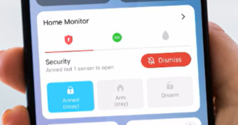

@DaneedeKruyff something like this? Coming from Smartthings this is something I miss on Homey. Be able to see and set the alarm state. Also be able to see if there is an active alarm, dismiss etc, all in one place with a nice overview
