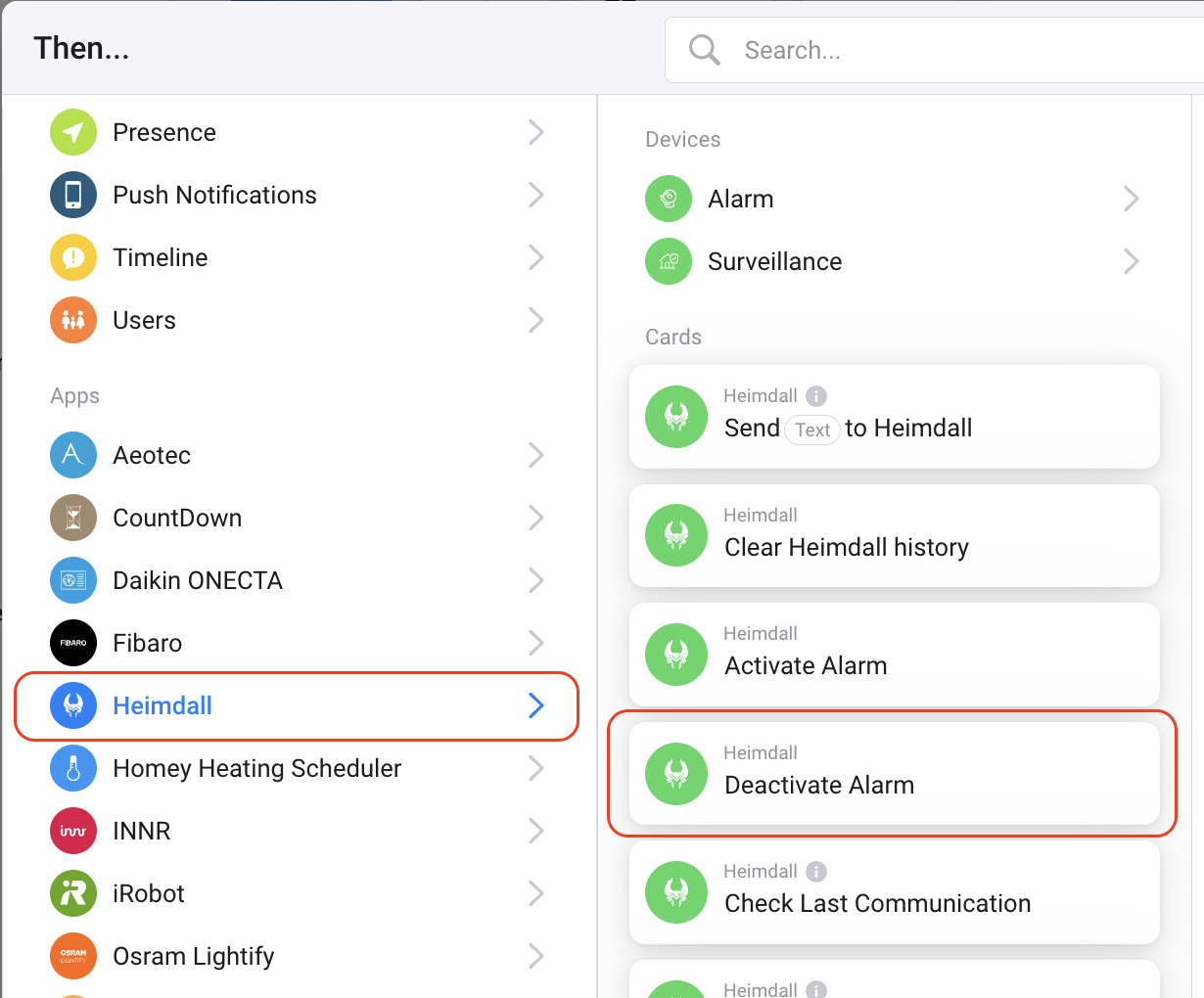

Hi, do you have info on when the update with the new cards to deactivate the alarm will be available?
BRG
Hi Mats,
Welcome here. I have no new update planned, and also not a need for your particular question, a card to deactivate the alarm has been available since day one.
It’s in the opening post of this topic: Heimdall - Let Homey watch over your home
Thanks for a quick reply. I was probably a bit unclear, what I was referring to was your post from the beginning of October, regarding Homeys update that was expected, to replace the behaviour and some cards. I still have the “press the button” card.
Do you know if the update is available, or is it perhaps just something with my installation?
Thanks again
The update you’re referring to is a Homey firmware update and is already available, so if you’re still seeing the “press the button” card you’d have to check why your Homey hasn’t updated it’s firmware yet.
Strange, my firmware should be the latest, 12.2.1 on a HP23. I have tried deleting Heimdall, and all the flows connected to it, plus restarting Homey. When I try to reinstall it, I still get the same cards…
Well maybe Athom did change something, I don’t know.
But what exactly is the problem? Because the Deactivate Alarm card is available in the app, regardless of any update.
I had problems deactivating a tripped alarm. I thought that using the device “alarm” could trigger a flow to stop the alarm. Guess it’s not the correct way, and that I should use a flow to deactivate it by disarming it instead. Thanks for your patience.
The Alarm Device is optional, so the Deactivate Alarm flowcard isn’t tied to it but available on the app level
Oh, and yes, deactivating the Alarm State by disarming is also a viable method.
