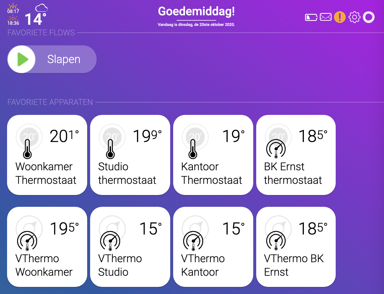

Any smart thermostat that is supported by Homey will do what you want. Hang it in a room, the moment the actual temperature is below the requested temperatuur (setpoint), have it start a flow.The required temperature can be set by the App Homey Heating Schedule.(the thermostat is not physically connected to a heating system, it only serves as a interface)
I have a setup where the end user can set a required temperature in a thermostat via his phone. That triggers a virtual thermostat (another App). So, the same as you would like to do, but with a smart phone.
Or, hang a tablet on the wall and have the enduser see this:

In Dutch I explained my system a bit more (here). Translated via Google:
My heating is a self-made zone system, in which Homey is the pivot.
I have an old house, in which two underfloor heating systems have been installed over the years. And, because a shower has also been added, a second boiler was added. A central thermostat that controls is currently not possible. The original ThemoSmart has been removed.
In my case I have:
temperature sensors in almost all rooms (Aqara zigbee or Aeotec z-wave)
I can turn the floor pumps on / off with smart plugs
I turn the CVs on / off with a Fibaro FGS-222 z-wave relay
there are 4 Eurotronic Spirit z-wave thermostatic valves for radiators
as “overflow”, two radiators are always fully open.
As Homey Apps I use:
Homey heating controller 10
Virtual Thermostat 1
Flows check whether there is a need for heat in a room (controlled by the App that has time schedules per room and also takes into account presence). If there is one, the relevant central heating will switch on and possibly an underfloor heating pump. For convenience, there are virtual thermostats per room that a user can adjust manually if the need arises.
