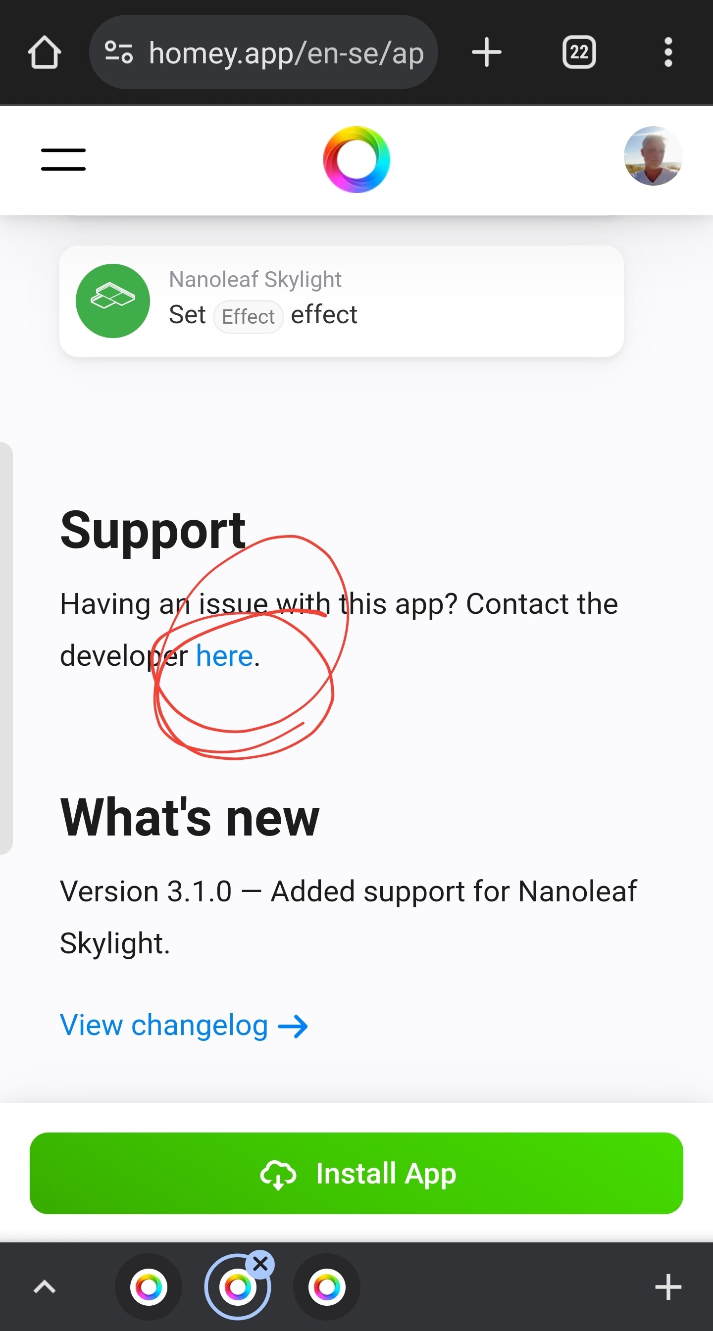

Tried to pair the Nanoleaf Skylight to Homey Pro 2023 but the directions do not lead to success. Any hints? BTW it does see the device at the start of install, but then fails the rest of the steps. I have tried with the Skylight installed already in the Nanoleaf App/Homekit and without.
What’s the developer view on this?
(:point_down: leads to Athom support…)
before I bug support I thought I’d see if anyone has had success.
