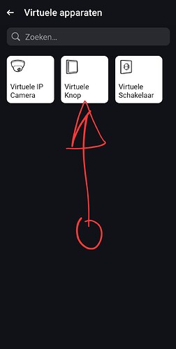

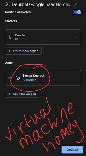

I have used, slightly, the same method, but then with normal automations/routines within the google home app.
The trick, indeed as mentioned by Christian, is to create a virtual device within homey which is being triggered within google home routines via a google nest device. In my example a doorbell.
But could you show me how did you install that virtual machine on Homey???
Hi @Sasan_Khandanpour. As follows

Hello thank you. Sow with this enabled it should work with the nest app or you have to do that fornthe sdm app to work?
Hello, thanks. Works great for movement etc. Problem is Google does not give me the starter when some rings the doorbell only different movements.
