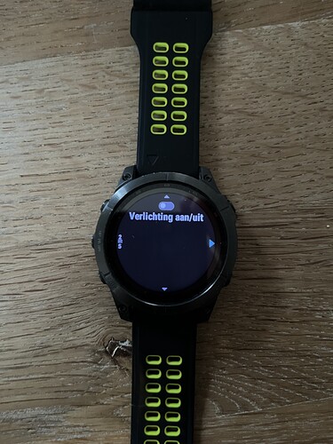

I See the (green) button and arrow to the right.
But when pushing the start-button or touchscreen nothing happend.

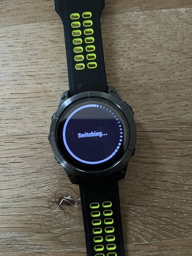

(Video its not allowed to upload. I tried both ways touchscreen and startbutton to switch. Screen tell me its switching but nothing change

at my watch i see the actual state of the switch and it seems to be switching but nothing occurs. The same as happend by clicking without ALT on a switch on my pc
