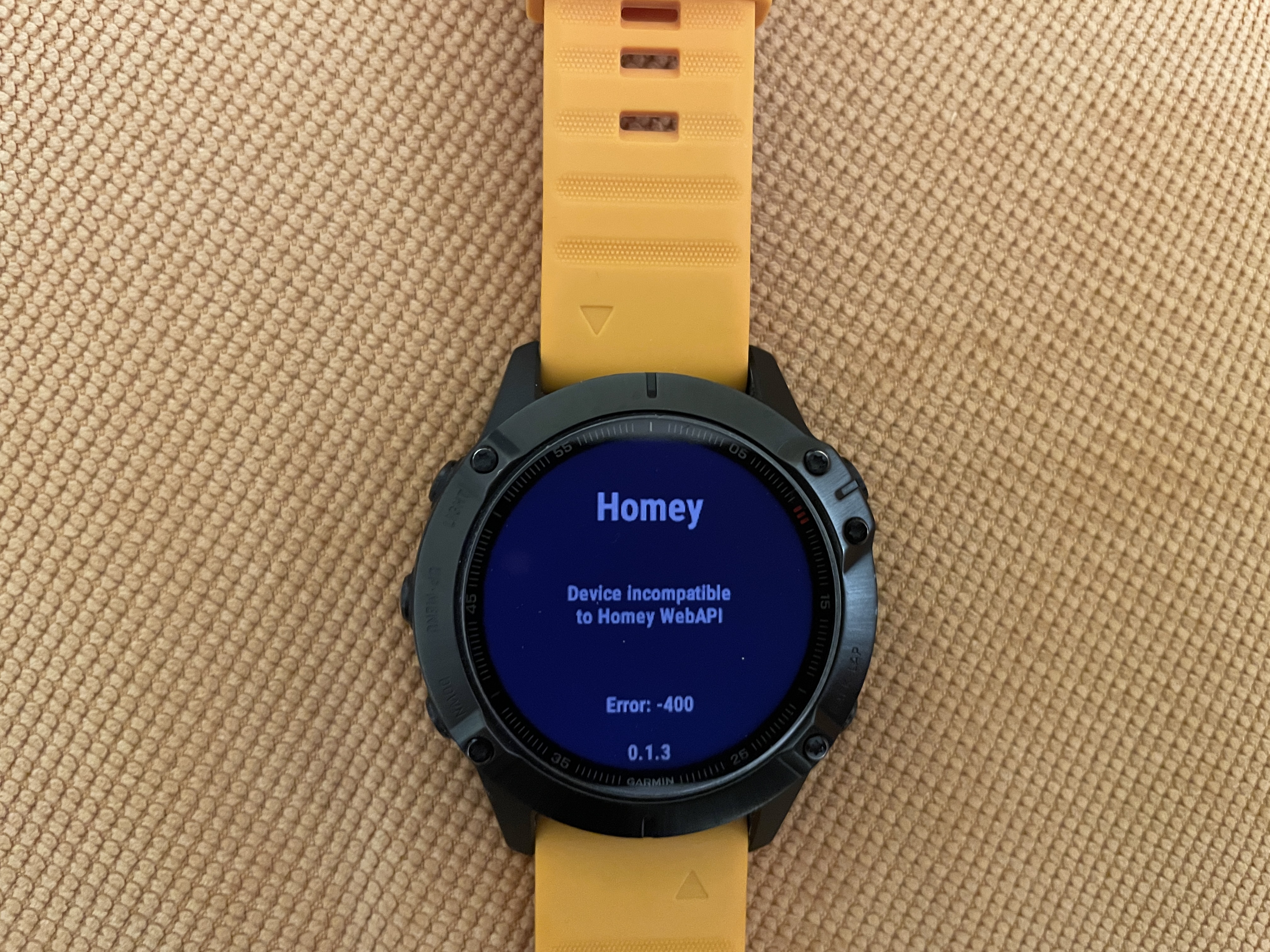

Yes iOS
I’ve tried today with the latest update. Unfortunately no luck. See the attached picture.
Kind regards
Zsolt
Yes. it’s the expected message for the iOS issue. Only readable text instead of error code.

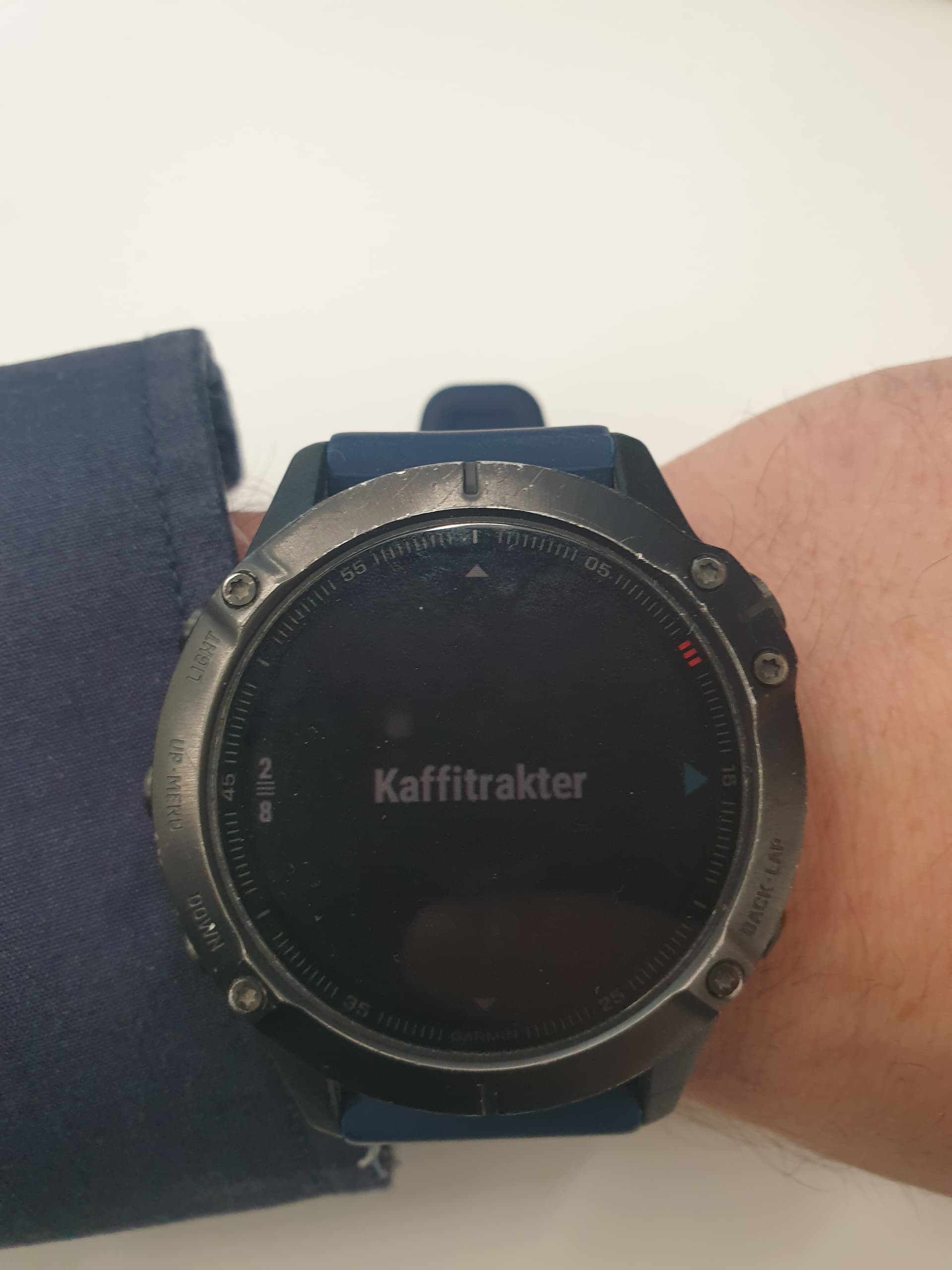

I get some funky behavior when entering the flow section of the app. The picture below is what I see first: 1/5 flows, and “Flow not found”, I actually have 7 favorite flows. If I scroll down I get 2/8 flows and “Kaffitrakter” (second image). They all work just fine, so nothing problematic really, just wanted to let you know :slight_smile:
