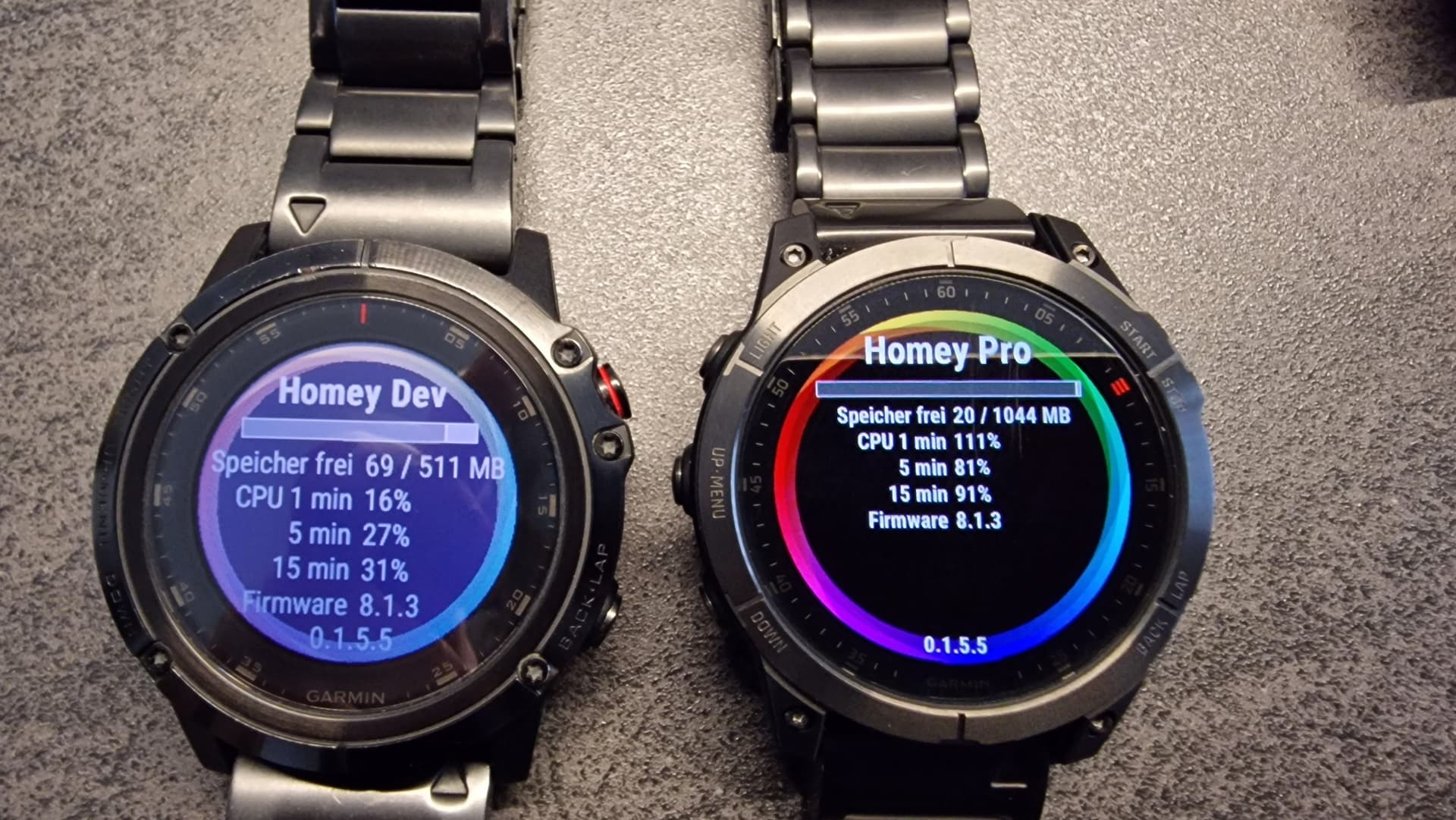

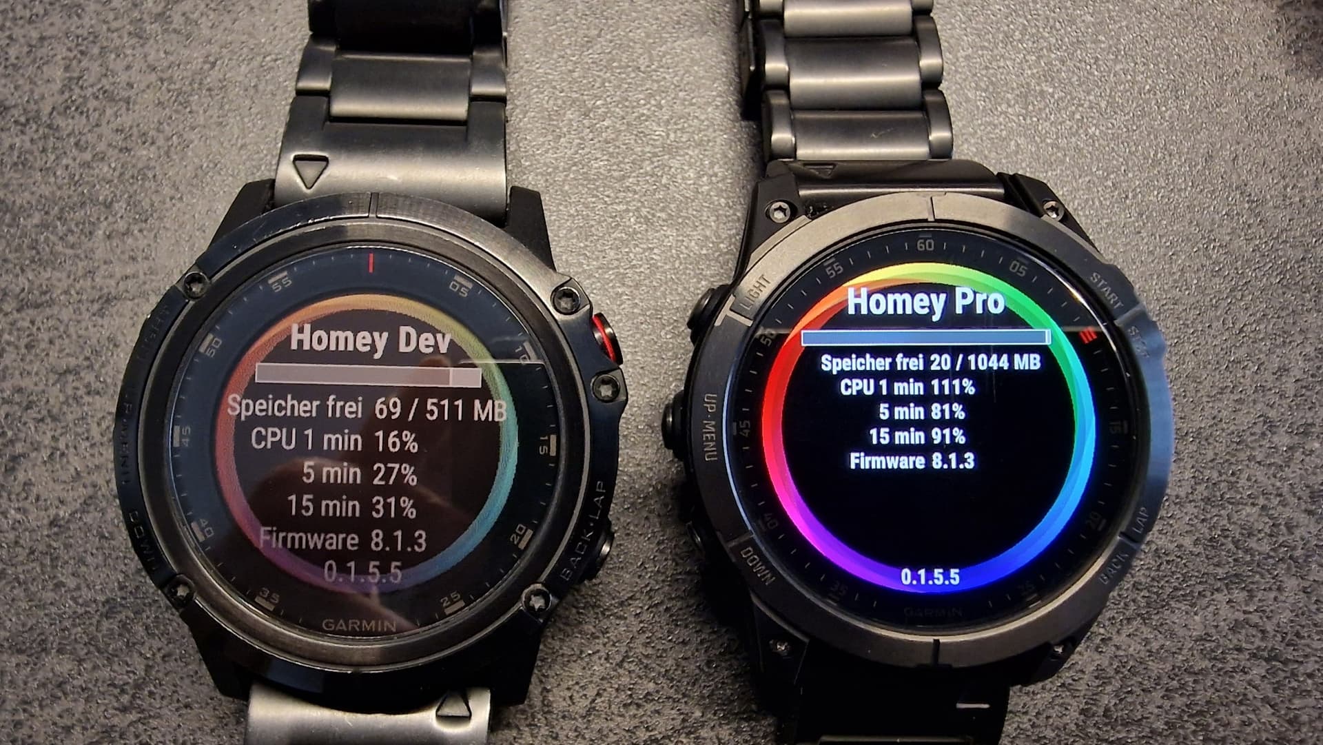

There is a new update coming (0.1.6)…
  • Added new devices (FR265, FR965)
  • Added a colorful Homey ring to the main view to get a bit of Homey feeling
    f0e8d90a97bab36111d8cb4015425a3e4908701b
It’s added for all round screens.
The other views will stay in clean design to not overload the CPU/memory and to not hide the navigation elements around the screen.
You can disable this background in app settings (using the ConnectIQ mobile app) or directly from the main view using the menu button.
If you have an AMOLED device, you will get a nice look&feel. The MIP displays will give a less colorful impression.
Here are live images from a MIP (fenix 5x plus) and AMOLED (Epix2) version.
If your Homey ring doesn’t fit into the screen, please send me your exact device name (oncluding s/x/pro…) and a foto, so I can adjust the resolution.
