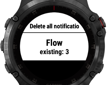

The notification category view will show a error message if the WebAPI response is too large. The WebAPI retrieves all existing notification in one JSON response. But with a lot of messages, it will hit the Garmin limit. But as compensation I added a menu tho this category where you can delete all (ALL!) notifications. Deletion per app is not possible at the moment because of limitations on booth sides for HTTP handling (Garmin SDK and WebAPI).
Holf the UP/Menu key and you will get to the menu:
grafik grafik
The menu lists all apps and their notifications. But that’s only for information.

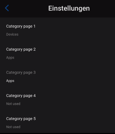

  • Configurable categories in app settings. Select the wished categories and the sorting in app settings (submenu “Categories”). If nothing is set, the default category list is used.

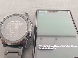

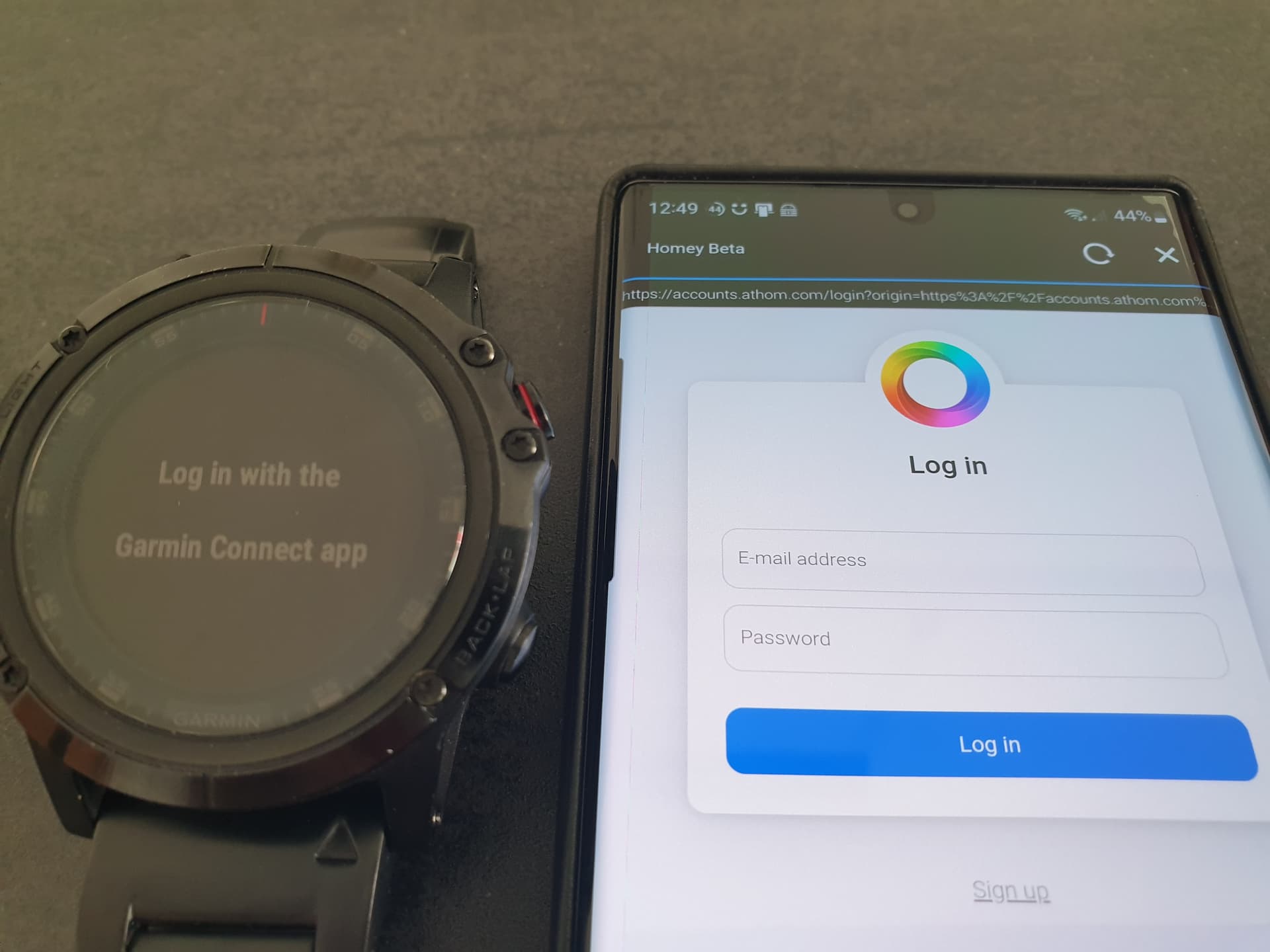

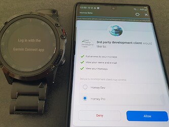

Here comes a short preview after many hours of hard work from my local test version :slight_smile:
I added a real oAuth authetication. This way you can authenticate the widget using the Garmin Connect app. Login with the Athom account credentials, select the Homey and allow the access.
The widget can login to Homey and refresh the login if needed. No update of tokens is needed anymore.
But I still wait for an answer from Athom if they will offer me a WebAPI key for the widget befor publishing it. So let’s hope it will be allowed shortly.
