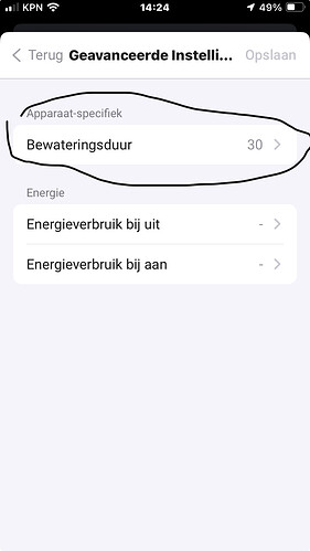

There is a setting on the Gardena-Device in Homey > Water Duration.
Go to your Water-Device on Homey > Tab the gear on the right top (on iOS is the gear there) > Advanced settings:

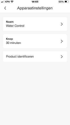

The setting in the Gardena-Company-App is for the Water-Duration when you use the Button on the Water-Control itself.

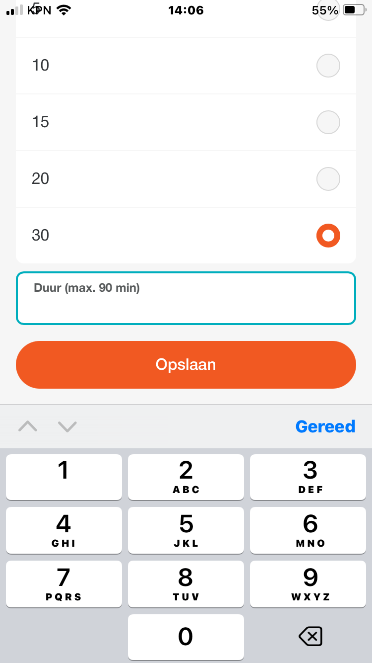

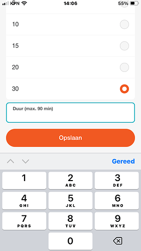

In settings Gardena app:
Your setting in Gardena will syncronise in Homey.
Thank you all for the help. I looked at the duration in the Gardena app before and it wasn’t that. But when I looked in the advanced settings in the Gardena app within the Homey app, there it said 1 minute. When I changed that it worked.
