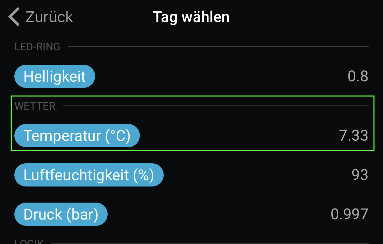

– Temperature ist greater than 3 °C
(Logic → (tag) is greater than → tag → Weather “Temperatur (°C)”)
