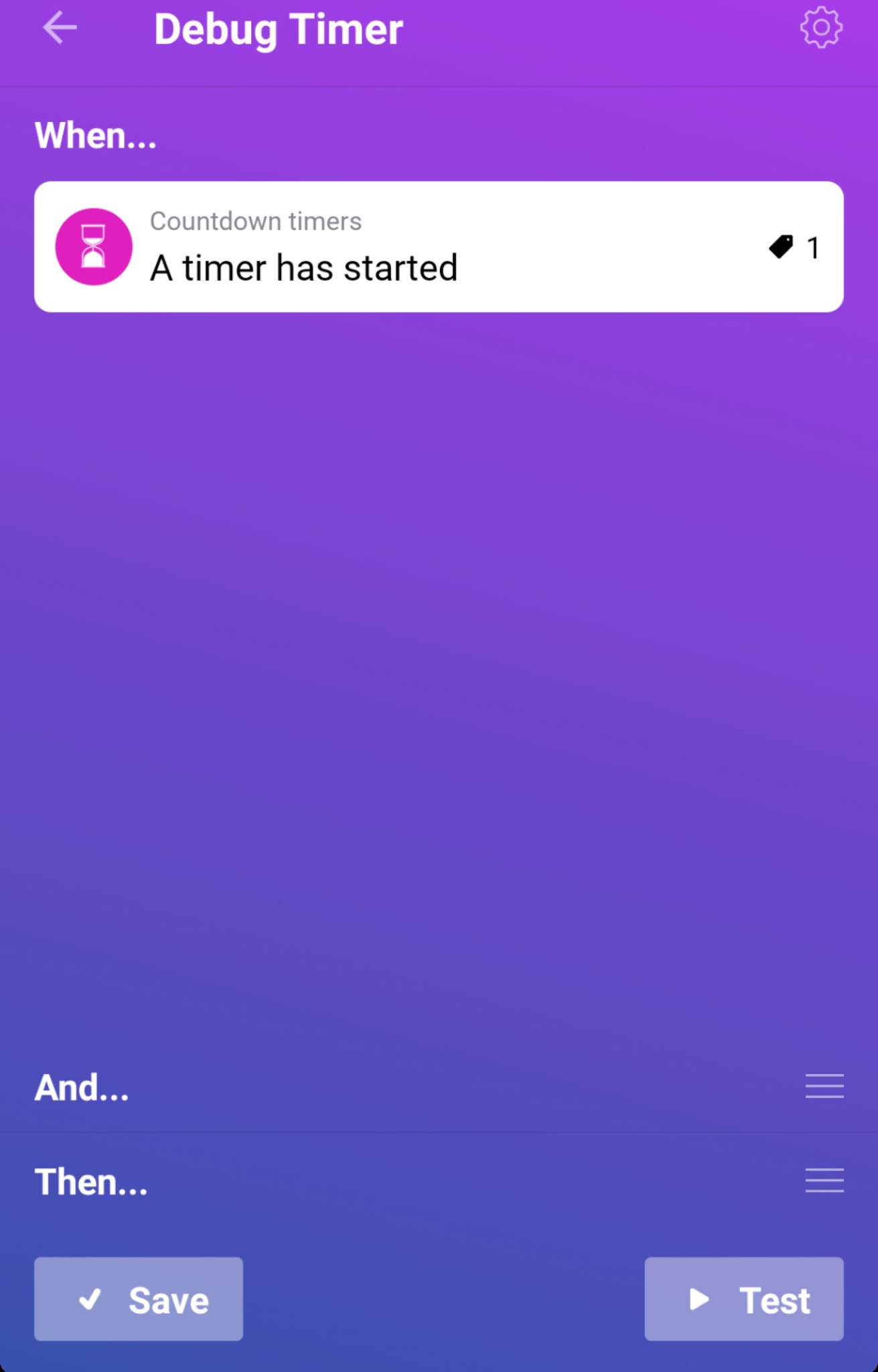

Ok thanks, I need some time to test this, cause the countdown timer don’t work for me. I did some very simple stuff (when: timer has started, then: send notification) but that wasn’t fired at all. So I need an alternative app for countdown timers :confused:

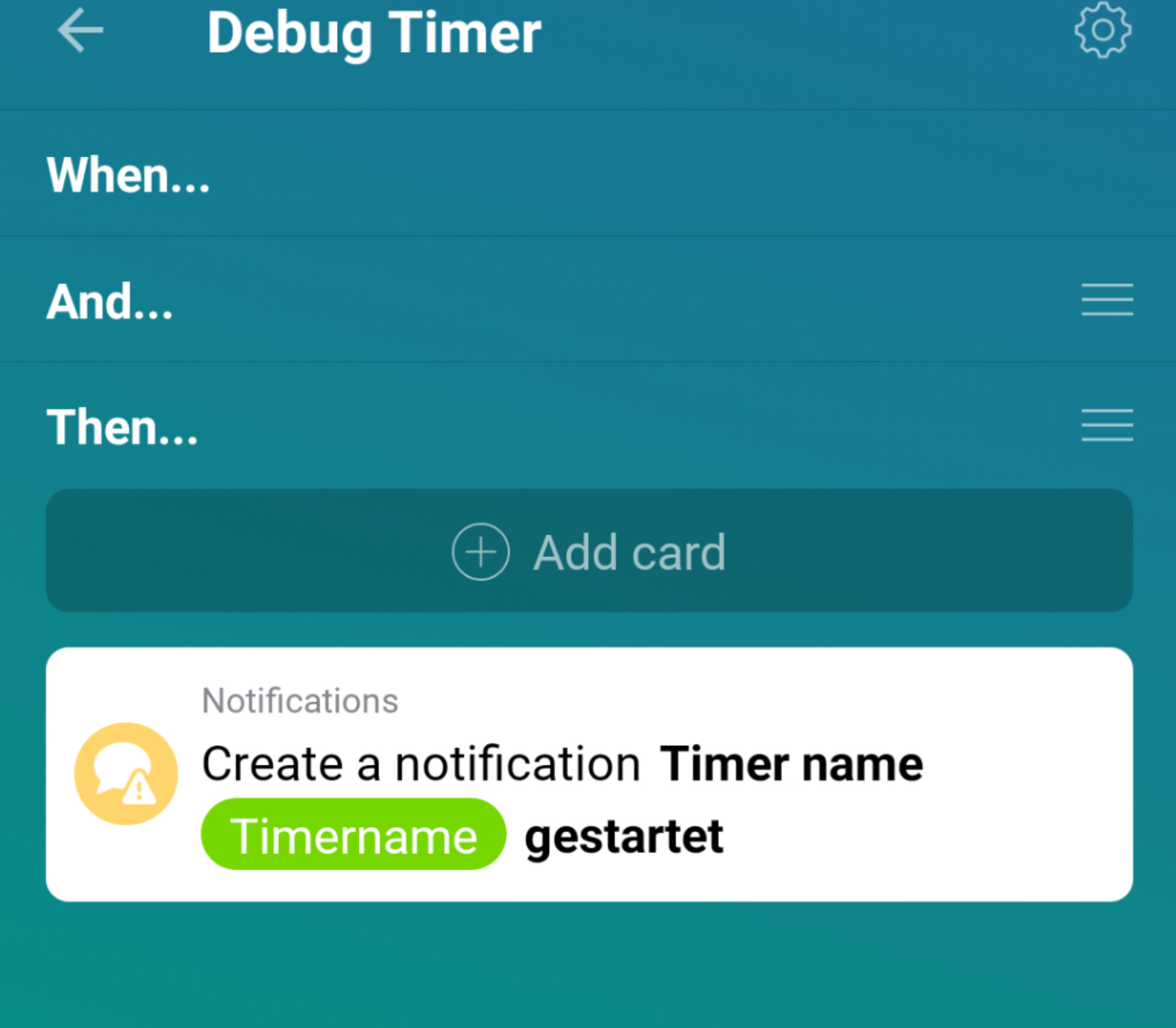

Can u show us the screenies of this flow(s)?
Sure, here are the screens
No rocket science here. :slight_smile: I also tried the beta of Countdown Timer App. Restarted homey, only the app and it didn’t work. Only thing left ist that I’m using a German special character in the devices name (ü).
Oh shit… this was it… The timer does not support Umlaute (üöä) in its name :smile: I will file a bug report.
