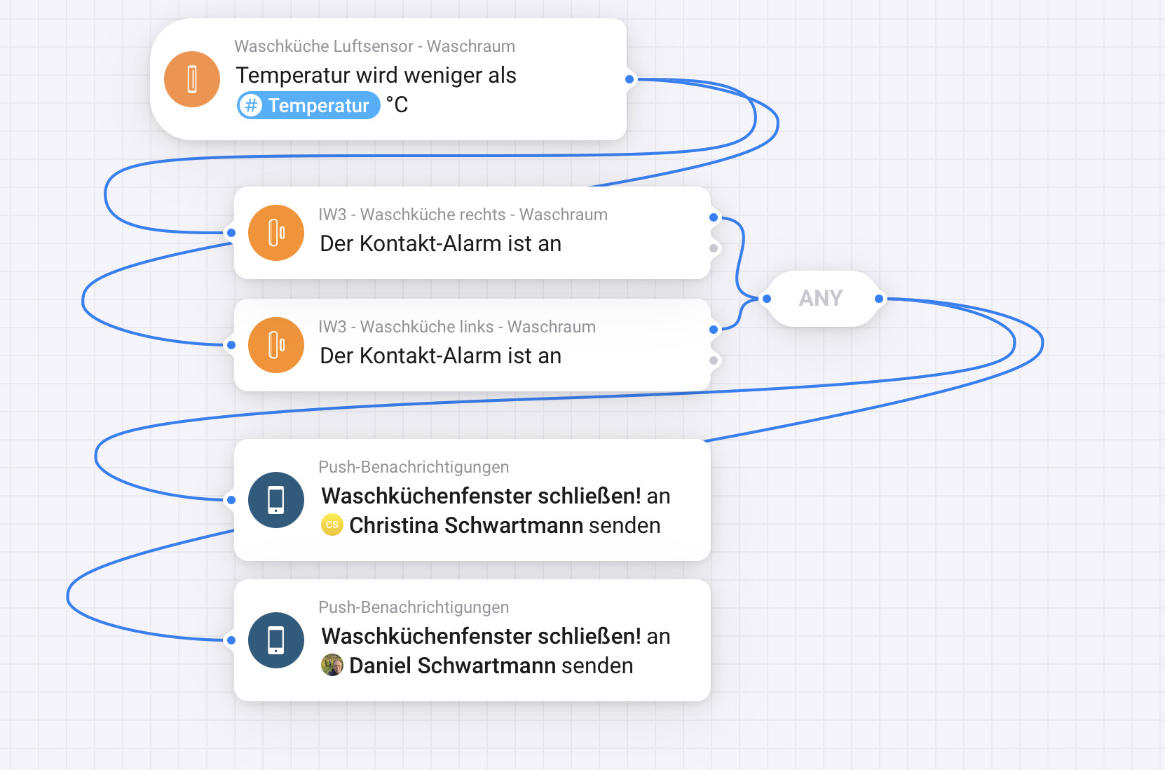

What I would like to do is e.g. a push message being sent whenever the outdoor temperature is higher than the indoor temperature and the basement windows are open (as this would drive humidity in the basement).
I have created an advanced flow according to that logic using a card from the Netatmo app "When the Temperature from the Indoor Air Quality Monitor becomes lower than “temperature” (the variable taken from the Weather Station) and the windows are open, then send a message. but it fails to send messages. I’m wondering how often the “when” conditions are being triggered by Homey or whether I need to add regular time triggers (like “every hour”).

I have used the “if condition” related to the Aircontrol sensor in the basement and compare it with the temperature variable that’s shown in the selection table under the outdoor weather station.
Okay, this is a different situation than you described, because the issue here most likely isn’t with the temperature but with the way you deal with the contact sensors: they have to be on right at the moment the Waschraum temperature drops below the threshold, and chances of that will be low.
You need to turn your flow around:
  • WHEN any of the contact alarms is turned on
  • AND inner temperature is lower than outer temperature
In general, I don’t see anything wrong with the flow.
The only thing I would possibly change would be to use the outdoor module as a trigger instead of the indoor module.
If the temperature in the “Waschküche” is relatively stable, then the flow is triggered very rarely. The outside temperature will change very regularly in comparison, so the flow would be triggered much more often.
