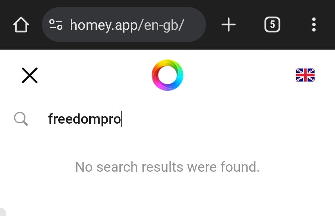

You can’t connect it, while there’s no app for it, you can search the app store yourself:
However, if the device can be paired using the mobile Tuya Smart app, or Smart Life app, you can use the Homey app Tuya Cloud to control it.
