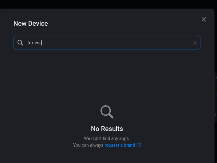

I’m new to Homey, I am wanting to add my solar/battery system to myhomey however I don’t see any app so can someone please offer help/support on what my options are. I use the FoxCloud app on my iphone but is there anything I can use?
I have a Home Pro Mini (New version) with a Bridge for extra devices/features.
Thank you
