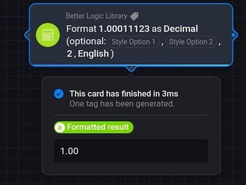

When you have the Better Logic app installed, or when you don’t mind installing it, you can use this flow card.
(you can use tags/variables in the first value field)
Dutch format
English format
Peter: Hmm, I don’t have a Format flow card, below is all I have. Do I need to install/update something?
I think that specific card is only available in Advanced Flows, not in Standard Flows.
Indeed, I forgot to mention that detail.
Because that particular card passes it’s result to a tag, it can’t be used with standard flows.
Standard flows can only pass tags from trigger cards.
