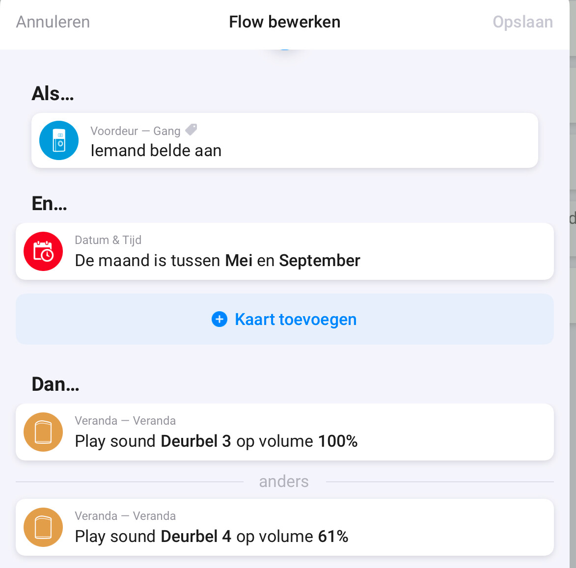

Here are the Flows:

I dont speek Netherlads, but the second flow will only run between Mai and september, so in Mai, June ,July,August,September.
that means today (January) i will not run at all and that ist correct. Switch to “between September an Mai”…
I think that ould be the solution. Or am I wrong?
It’s a If…Then…Else constructies:
If
Someone rings the bell
And
Month between Mai and September
Then
Play Sound Doorbell3
Else
Play Sound Doorbell4
So it should work always, but play a different sound depending on the time of the year…
@Thomas_Abel I think your wrong.
IF the bell rings
AND it is between May and September
THEN Play sound 3
If not between May and September
THEN Play sound 4
So if it is not Between May and September then Play sound 4.
Ahh . Ok , now i see….
Thanks for the correction and sorry for my stupid mistake.
