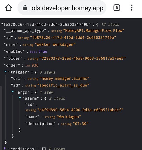

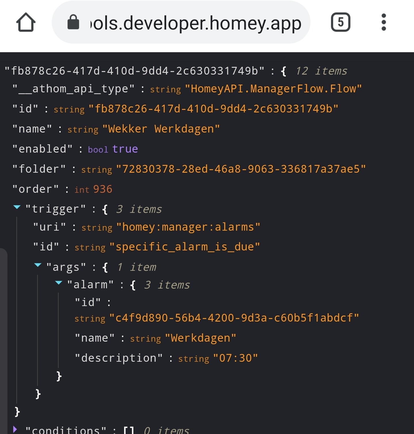

I made a flow and searched for it @ api playground.
Homey.manager.alarms seem to be the “device”.
specific_alarm_is_disabled is what you need, but idk how to script that yet.
The specific alarm clock id in my case is starting with c4f9d890-
