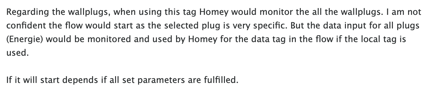

This is Athom’s last answer. After that I give up:
The “LokalTag” is and will remain a black hole for me.
“in this flow”/“local tag” is the tag that is coming with the trigger flow card (IF column), this tag is normally empty until the device triggers the flow and fills that tag with a value, but only for use in that flow.
That is also why the play button is greyed out, as the tag is used in the flow, but is empty until the flow is triggered by the device.
When you test this flow, you fill in this tag manually.
“normal” tags is the last available value (of the capability) for the device, so is pretty much always available, even without the flow being triggered.
the first option (local tags) was the only option few years ago, before (the then called) global tags were implemented.
Which variant do you prefer? Or does it differ from flow to flow? If so, when should you use the Lokaltag and when the Device Tag?
Spontaneously I would say that you should use the Lokaltag. This value is up to date.
With the Device Tag it could happen that the device hung up a few hours before and delivers the wrong value?
