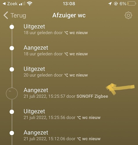

I have some issues with a SONOFF device that is turn it self on or of (most time on) directly after is has been turned off by a flow endcard.

Yes, look at Device Capability, is has a trigger (when) or beter for you, an Action (Then) card to retrieve the last user who pressed on/off.
Here an example how to use it:
You just need the Card “Retrieve the value of [device] for [capability] for 0 minutes ago”.
For you that would mean, Retrieve the value of [afzuiger WC] for [onoff] for 0 minutes ago.
The Retrieve card also has a token with the value, which you can check for true or false in this case.
But i guess reading your question again, i think you would just need the Turned on trigger and the Retrieve card.
So, actually you would need this:
(Check if you need the token Client or User, but it should be Client for Apps)

It is the cliënt. It is working!
