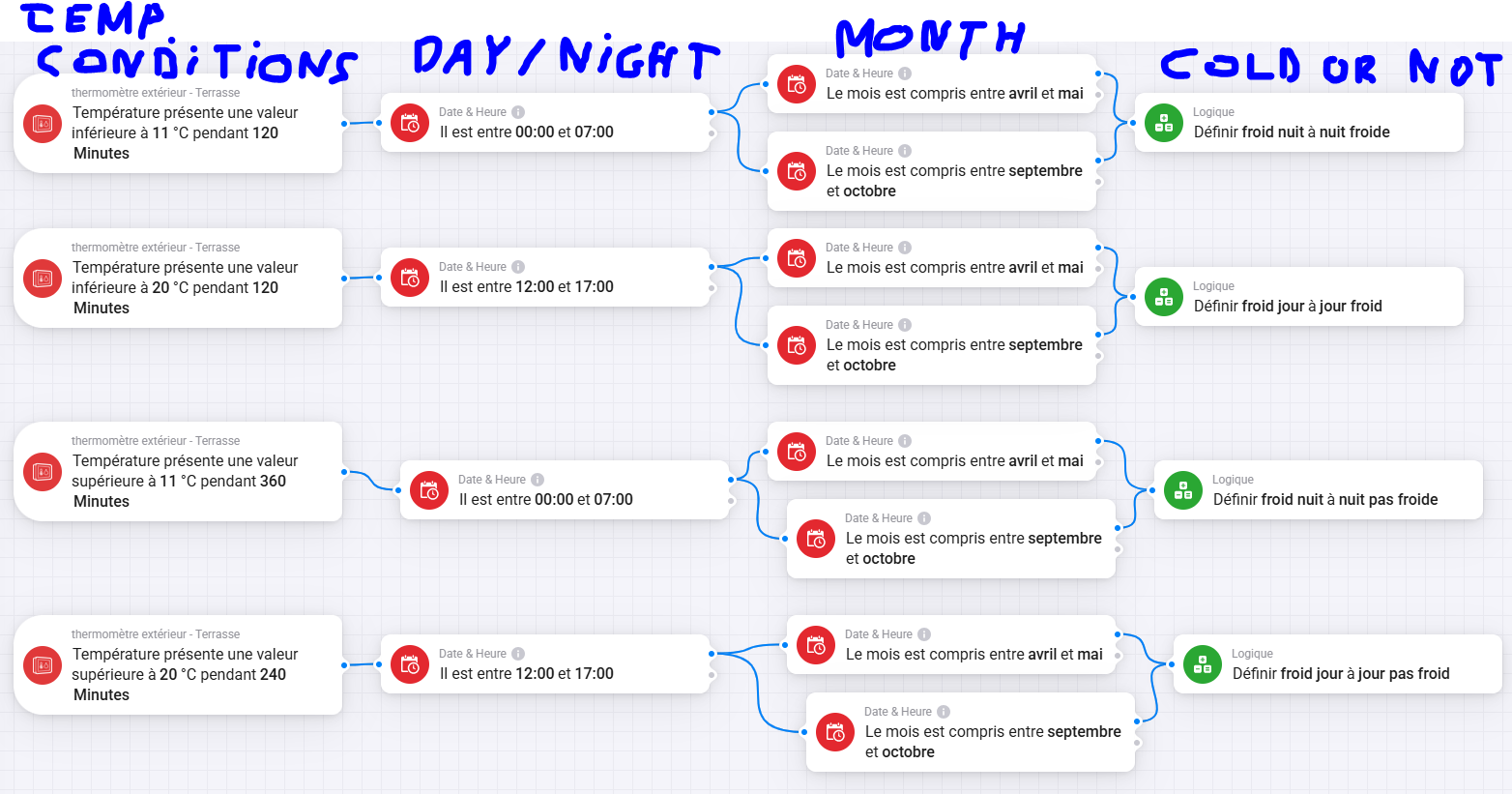

THello everyone, has anyone tried the new possibility with 1 status of 1 sensor for a certain duration? I was manually activating/deactivating my heating, during the heating period it was automated by homey (when it is more than 20 degrees outside it stops). With this new option I would like it to stop/start automatically when the temperatures become colder/hotter. It will be with experience that I will see if my temperature values are correct, but do you think my flow is good? Any advice to improve something? (it is only the flow that regulates the variables used in 1 other flow that starts/stops the heating, which works well =>when night and day become cold, start to heat)
