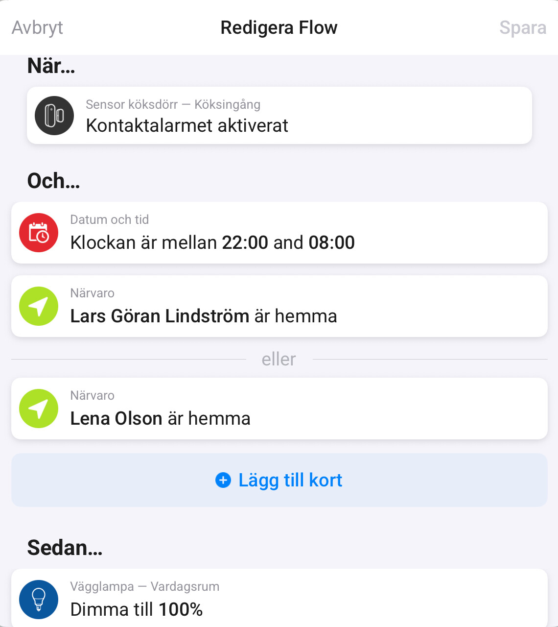

Flow runs although criterias are not fulfilled
The flow is:
WHEN contact alarm is activated (door open)
AND
DATE AND TIME time is beteween 22.00 and 8.00
PRESENCE Lars Göran is at home
OR
PRESENCE Lena Olson is at home
THEN
Dim light to 100 %
The flow runs every time the door is opened even if time is not between 22.00 and 8.00 and we are at home. Where is my logic wrong?
This fliw will run when Lena is home…..(the OR is true).
So if I add the time condition for her too it will work! Thanks for the help!
Additionally: Homey is not good with different dates in time conditions.
Hence I always invert it twice:
AND it’s not between 8.00 and 22.00 hours
This results in true, when the time is between 22 and 8 hours, regardless if it’s before or after midnight.
