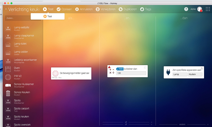

Want to make a flow which turns on the light when motion is detected and the lux value is below a certain treshold.
I am struggling to get this working. I tried to use the card “motion detected” in the if part, but I have no way to select the lux value in the and part of the flow.
Could someone give me some pointers how to approach this?
See the flow below which I tried.

In the if column I could select “luminance changed” and that is where I got that tag from. Than I changed the if card to “motion detected”, but than my tag which I use in the logic card stops working. Not sure how to check for lux value. What I want to achieve is: WHEN motion detected AND lux less than 100 THEN turn on kitchen lights.
There is a tag menu at the top of the flows page. Find ur pir and drag the “helderheid” tag from there into ur logic card in the AND colom.
Lol, so simple… did overlook that. Already thought I was doing things way to complicated. Will check when I am home. Thanks!

Hy everyone! I try also to turn on a light when there as a motion alert and when the lux is lower than 10. The problem is that it always turns on, whatever the lux report is. I changed the parameters in my fibaro sensor:
Report treshold 50
Report interval 10 (for testing I use a low value)
It’s driving me crazy!!! It should be so easy to do !!!
And what happens when u hit the test button on this flow?
Hi Roco! Every block passed the test… I made a screenshot to show you. The lux at that moment was 192lm. The light condition doesn’t work…
Then my best guess would be that u used the wrong tag. Can u double check that?
Yeah, in the mean time I tried “Luminance” in stead of ‘intensity’ and it’s working!!! So, you where right!!!
