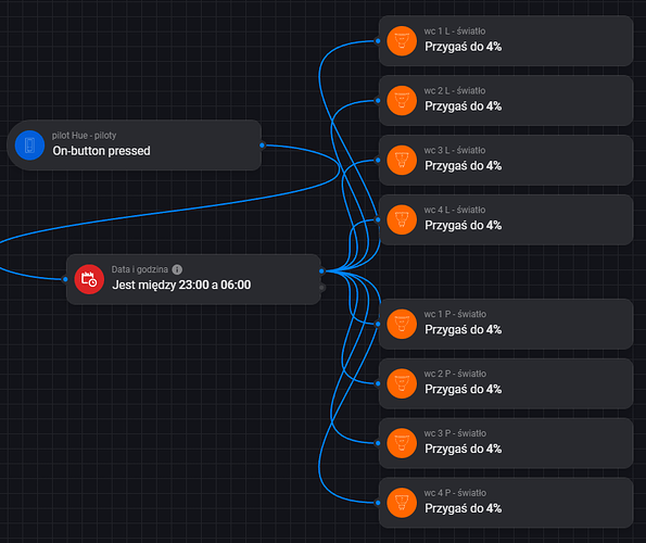

Hi, I have a question, how to set the lighting so that when I turn on the light in the bathroom between 11 pm and 6 am, it dims to 5%. Theoretically, I made such a flow, but I noticed that casami one or two light bulbs will not dim and shine at 100%. It drops randomly and on random bulbs. The same happens with flow, turn it on and off, it happens that sometimes one of the bulbs will not light up or will not go out for random situations and for randomly selected bulbs.
I have to press the button again for the non-dimmed bulbs to dim or turn off.
The bulbs are osram zigbee integrated in homey pro, and the remote control is philips hue also integrated directly into homey pro
