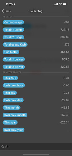

With this a pictute of the “current output” selected from the “and” logic.
At the moment the output is lower then it needs to be in order for the flow to work. Il adjust it to within limits and test everything.

To understand it a little bit, what does „Current usage: -609“ exactly mean.
The current usage is the power consumption minus the power production in Watts. Your trigger for the flow is when the target temperature has changed, that is a setting of your sensibo. You have to replace with a trigger when temperature (don’t know from which sensor you are using temperature in the AND part).
You have to use the card “The temperature changed” and not “The target temperature changed” in the “When…” section.
The -609 means i am putting -609kw energy back on the net (solar pannels)
