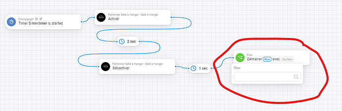

Hello
I have a problem, it does not offer me any flow with this card :slight_smile:
That refers back to this same flow. You need to save (and name) this flow first (without that card) then you will be able to add this card referring to this flow by the name you just gave it
So to be clear in my example above the flow was saved as “Blink light” and that’s what that card refers to

This is my problem too. I just cant choose any flow, but i have a ton lol. What was the solution for this?
Dont know what do you mean with this. For me the flow got a name and also saved but i cant choose any flow. There is none when i want to use this flow yes/no card.
Have you already added the “This flow is started with a yes/no tag” WHEN card to the flow before you saved it? That’s what should make it appear in the list of flows to choose from when you add the “Start flow with yes” THEN card.
If you already tried that, maybe refresh the web page in your browser while the advanced flow is loaded. I’ve found some changes don’t seem to get fully reflected until you do that.
