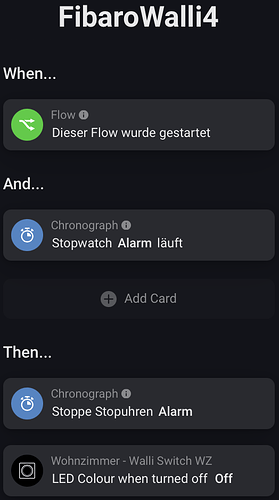

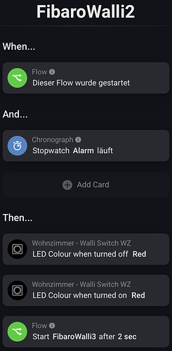

Made some tests. With these flows it’s possible to let the Walli LED ring “blink” every 2 second. With 1 second it doesn’t work. I guess the Walli LED ring is to sluggish:
The trigger of the 1st flow “FibaroWalli1” should be of course “Alarm triggert” from Heimdall app or something else.
And for the 4th flow you can use “Alarm is deactivated/disabled”, a button or something else.
But if you use these flows for multiple Wallis, it’s probably a high load for Homey and/or the Z-Wave mesh. Don’t know if it makes sense to use the < group > app for this.
So I am not sure if this is a good solution. A siren like e.g. from NEO is probably the more suitable solution.
